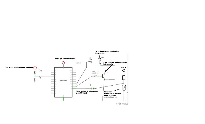

In the weekend I assembled the prototype perfboard to star testing the code inside the car. (it was already tested on a protoboard but using always 5V.
THe bad news is I already blew 2 arduino pro mini. At first it was a current limiting resistor problem with the BJT´s. When I solved that the second arduino blew the same way. They are not totaled, but the pins 9,8,7 are shorted. The first time could have been the bjt resistors (also a bjt blew) but the second attempt had me guessing
The problem was that I was trying to see if the ignition sensing part (voltage divider worked ok, and it did) then I moved to the door switch part (with the diode)
In the cathode part of the diode things worked as it should (0V door opened, 12V door closed)
But the arduino never registered the switch from high to low. Then was when I realized some pins blew over and the atmega chip started getting hot (on both pro mini)
They are not rendered unusable (still) the analog pin that I was using still work on both, I also have a HC 05 BT module attached, in the second pro mini used, the TX/RX pins must blew over, because I have no serial comm, but the HC 05 works fine.
Here is the schematic can anyone point out the error?
I realize that on the Pin7 (which uses input pull up configuration) there is no diode to +5V as suggested. I was just testing the pcb with the engine off so that no negative voltages were risen at the test.
The resistor values on the analog input are far too low for safety, need to be at least ten times. While my advice about the diode remains, there is a risk that that input could be driven negative if the grounding of the Arduino to the car frame is insufficient. This is a particular risk when you are using the same ground to switch your solenoids (or whatever they are).
You need a second diode with its cathode to the anode of the first and its anode to the microprocessor ground, and a 1k between the common point of the diodes to D7. The emitters of the transistors also need to connect separately to the car frame.
Design for automotive applications is not trivial!
