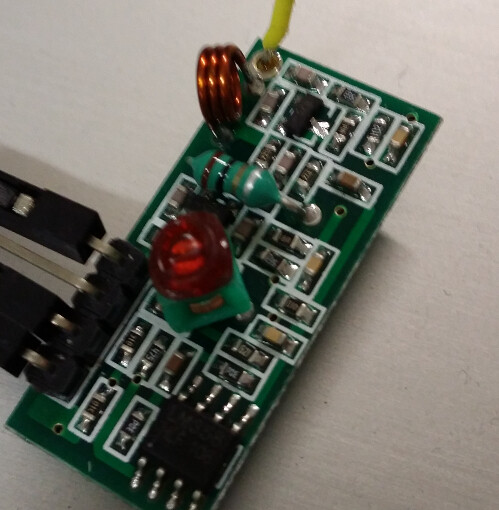

I have the same issue of very short range and from the pictures, it looks like I have the same receiver (as the OP). I'm using 7" wire (22 swg solid core) as the antenna.
On the receiver, is the small coil (an induction coil) supposed to touch the hole where you connect the antenna? In my receiver, it looks like the traces touch. I can't find a schematic for this card to verify. I'd like to get some feedback on this before I try separating the two.
