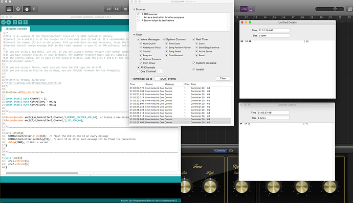

HI PieterP,
I found some software called SNOIZE.
I'm not sure if this provides the info you speak of, Sceen Shot attached.
C/W is giving a reading of 64, CC/W a reading of 62.
From the Analog Lab info quoted before, I think the VST is looking for a reading of 65-67 on C/W, but we're only giving it 64. Is this the problem?
Dizzwold.
That seems to be a bug in my library: the mode is called ADD_64 but it adds 63, sorry about that.
It's should be fixed now.
Pieter
