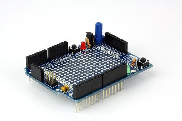

I'm interested in building a prototyping shield, so I'm wondering which of these would be better.
I have one of the sparkfun shields, and it isn't bad - but I'll tell you what is (IMO) best: a 2520 tiepoint breadboard
These are sold by many companies and on ebay; essentially they are 3 of 840 tiepoint breadboards side-by-side, with a separate power-bus set of tiepoints at the top, along with banana-plug jacks at the top on a piece of plastic (or in the better models, alluminum or steel).
Get yourself one of those, then mount it and the Arduino on a piece of plywood, mdf, or a cutting board (HDPE or wood - whichever) with some screws and standoffs, and you'll have an experimentation kit to be envious of. You'll also need a set (or two - or three) of jumpers (but I typically use solid-core stranded wire from 25-pair telco cable, or solid-core cat5e).
I've used and been happy with the Sparkfun boards in the past but I found their costs, in fact the costs of prototype shields in general, a bit expensive. So lately I've been using Oomlout's budget proto shields. Not quite the same quality (singled sided PCB as opposed to double-sided PCB) but they do the job.
If you are making a semipermanent project the proto shields are good. You can make stuff like this:
http://yourduino.com/camera-control.htm
If you are doing a lot of experiments, I agree the larger breadboards are better.

you can check also our proto shield PROTO-SHIELD - Open Source Hardware Board
you have access to vcc and gnd near every pad
also it allows you to prototype with SMD ICs
