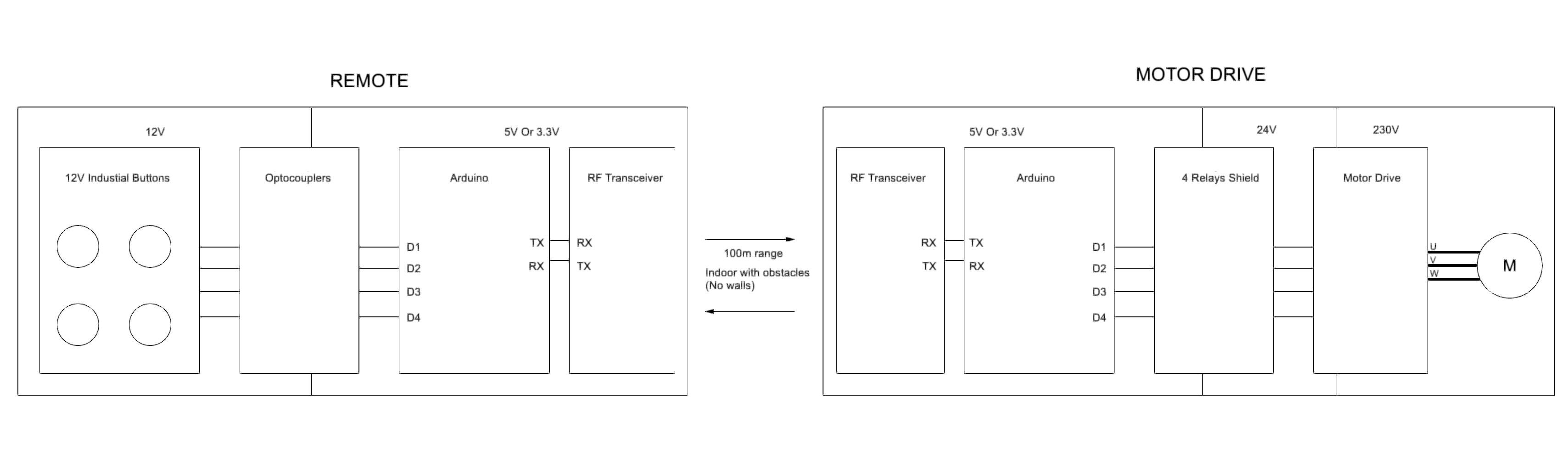

Hi all,
I spent some time on this forum looking for the best way to connect two Arduinos wirelessly.
Here is a simplified schematic of the system :
One Arduino will be used as a remote, and the other as an interface to control motors drives, the range must be about 100m, indoors, with obstacles such as wooden frames and fabrics but no walls. Some safety will be implemented in the code (the motors will stop if the connection to the remote is lost for example), but the project still needs a robust connection to avoid the motors stopping because of a lost connection.
I found the HC-12 module, which seemed to have sufficient range, and easy setup (just sending character via serial !)
I also thought about the Digi XBee® RR Module from sparkfun, with arduino shield, but it seemed a bit too complicated to setup.
Do you have other suggestions ? I saw the MKR family for example, but it didn't seem suited to the project. Budget isn't an issue.
We use hc-12 on a couple of projects and is working reliably.
We use a 'standard' setting of 11dbm as in the same environment there are a few different units ( working on different channels ), and increase it only if necessary ( non standard applications ). Good product, and super simple to setup ( we previusly used a bluetooth module that required a binding between rx and tx ), with simple addressing you can do 1-to-1, 1-to-multi...
Thank you for sharing your experience with the module, we might go with that !
Plus, Half Duplex is enough for the project.
I am also interested in this topic. I have two HC-12 devices under test now talking to each other and lighting a led to indicate transmission/receipt and they seem OK, recovering from power cycles at either end etc. I've tested using two of the transmission modes , FU3 and FU1. The concept is that they provide a serial tunnel between two Arduinos so are easy to use. I've not yet verified the power consumption but with a claimed 22uA in sleep mode, should be suitable for long term battery operation in the case that small amounts of data are transmitted at intervals of tens of seconds or more.
However, they do not seem to provide any error checking and automatic retries, such as is provided by the NRF24L01 and others, so you should probably include some sort of check sum with any data sent to be able to recognise any errors in transmission.

For robust or reliable communications I would suggest the following is needed;
  1. You need to use a send and acknowledge system, so you can be sure sent data has been received.
  2. Data sent should be protected by a data CRC so you don't attempt to act on corrupt or rogue data.
  3. Data sent should be protected by an ID so you can be sure the data being acted on is not from some other source.
  4. The modules should be capable of a longer distance that they will actually be used at, preferably at much greater distances.
  5. You should be able to configure or change the frequency of operation, so as to potentially avoid external interference.

  1. The remote sends a command each 100ms, the motor side will answer with a status update each time. (And a safety timeout will be implemented in case of lost connection)
  2. I intend to use CRC - Arduino Reference
  3. Good idea for the ID, I'll add that to the packet
  4. The HC-12 is supposed to be able to reach 1000m range, and it'll be interfaced with an antenna.
  5. The HC-12 working frequency range starts at 433MHz and ends at 473MHz, I hope it'll be enough !
