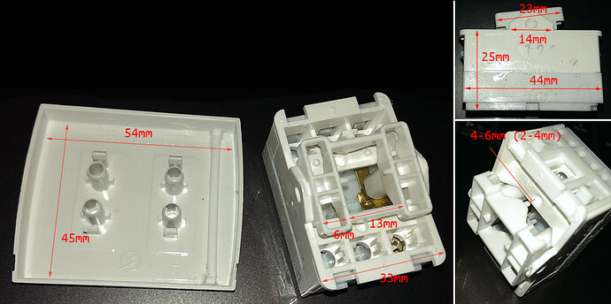

My goal is to control the switches and know their current state, but without interfering with normal (manual) use and using specialized switches.
You can see my initial test setup here (- YouTube). It uses a servo with some fixed strings, and I planned to put a custom made switch beneath one of the "teeth". Input to the switch would be the same + wire going into the servo, and output would be a "sensing" wire, so I'd need 4 wires per switch. Using nylon/plastic strings would make it more reliable, but I still don't like it too much.
And here's what I'm aiming for:
  • place wires into walls
  • use SFTP network cables (8 wires per cable)
  • use as few wires as possible
  • use wires as short as possible (7m max, though I've tested the servo with 15m and it works)
  • modify existing switches
  • automation must not interfere with normal operation of the switch
  • add a component to mechanically flip the switch on and off
  • add a component to sense the state of the switch
  • components should be reliable and not malfunction (repairing would be hard because they're going into brick/block and mortar walls)
  • components should be as small as possible, to avoid digging into the walls too much
  • safety - power used for the light switch (220V AC) must not interfere with automation components. This is my major concern. It might be complete nonsense, but I'm mostly worried about induction and the whole thing going up in flames or electrocuting someone. Please advise on this.
You can see the layout and size of the light switch I'm using in the attached photo.

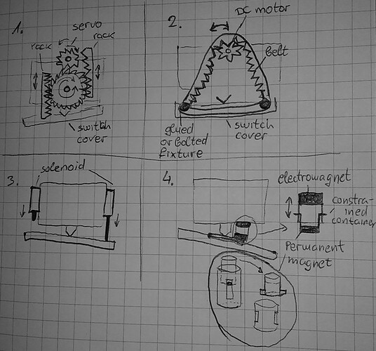

And here are some ideas I've thought of, but I'm unsure if and/or how they can be implemented safely. There's an attached drawing showing every one of them.
  1. Glue the servo at the same place as in the test, but instead of the cross attachment and strings use a gear, pinion and two racks (see Rack and pinion - Wikipedia). Trouble here is making the gears and racks, because they'd have to have just right teeth and be pretty small, and I'm worried about their strength and cost if I go with e.g. 3D printing.
  2. Use a DC motor glued at the same place as in the test with a toothed (conveyor?) belt instead of the strings. The belt would be tight, so manually flipping the switch would turn the motor as well, but unlike the servo it won't break because it's not constrained. I've disassembled one of my micro servos and found a small DC motor inside, approximately 7x12mm, but I'm unsure if I can make it spin both ways, as well as if it's strong enough. Trouble here is making the belt, because it too will have to be both small and strong.
  3. Use 2 solenoids, one on each side of the switch. Trouble with these is they'd have to be pretty small, which means I'd have to make them from scratch, and they'd have to pack enough of a punch with only 5V they're getting.
  4. This is something that might not even be possible, but seems logical to me at the time. Glue a permanent magnet at one end of the switching lever and place an electromagnet on the base beneath it. By controlling the polarity of the electromagnet make the two attract or repel to flip the switch. If this is possible the trouble would be getting magnets small enough and making the attraction/repulsion strong enough to filp the switch.

Actually I prefer building things by myself, but the basic components (e.g. dc motors) I rather get off the shelf.
If you take a closer look at my idea #4 (and it's drawing) in the OP you'll notice that it's a lot like a relay. It's got an electromagnet and attraction(+repulsion) behavior, but instead of closing a switch it pulls in or pushes out a permanent magnet.
I've also thought of just fixating the electromagnet to the top of the switch base and the permanent magnet to the rocking cover (without building a container I drew).
For this one reversing the polarity has to be done through an h-bridge, just like with a DC motor, as I understand, but that shouldn't be a problem. I'm just not sure if the attraction/repulsion will be strong enough to pull in/push away the rocking cover. I guess I'll have to try it out :slight_smile:

Frankly, I think your arrangement with the servo motor and nylon threads is most elegant and will prove the most practical for your specific requirements.
It actually provides excellent isolation - you can easily provide an extra barrier between the servo and the other wiring. Obviously you would separate the Cat 5 cable from the mains and that should not be a concern.
As to insurance claims - well, they are really not going to know the difference anyway. ;D
As in your demonstration, you get the servo to pull one way or another and return to the central position at which point you shut off the power to it (Need a control transistor to do that, or with the cable, provide switched power separately to all servos in parallel). The only real consideration is whether it is practical to carry the servo signals over the cables, or to provide a MCU module near each (which then means you have to arrange a communication protocol and interfacing).
Solenoids would require substantial current to drive and need to be fairly large. You may note the solenoid versus gear-motor comparison in car door locking mechanisms - they seem to have largely gone for the geared motor. The nice thing about a servo is that is a ready-made and cheap ($2?) implementation, providing your own gear train is otherwise a major undertaking. And nylon thread to connect to the switch should be durable.
