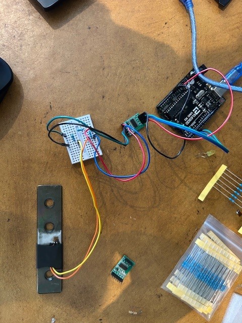

I am working on a personal project to learn a bit more about strain gauges and how to connect them. I currently have a BF350 strain gauge attached to a metal bracket for a desk. I have created a Wheatstone bridge using 330-ohm resistors arranged as shown. I am using a HX711 load cell amplifier and an Elegoo Uno R3 board. Please see the physical wiring below.

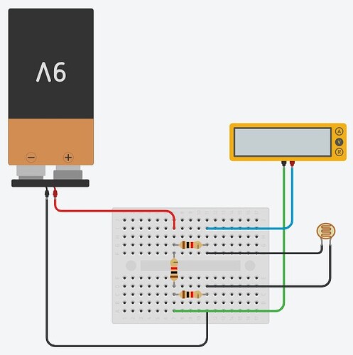

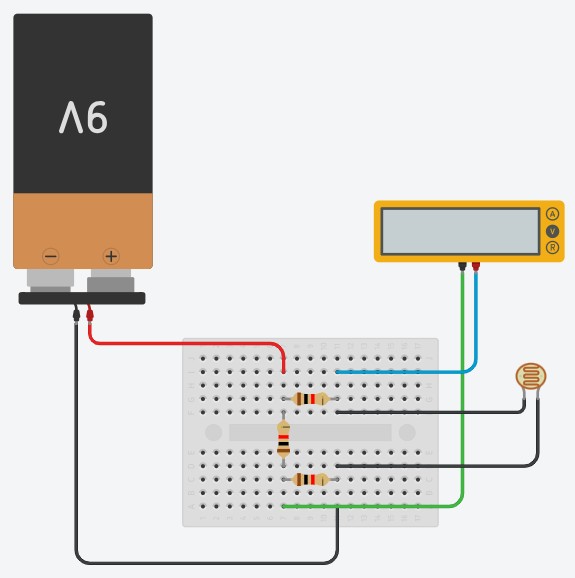

I tested this circuit on TinkerCAD (albeit without the HX711) and the colors of the wires are all the same. For the HX711, red is E+, black is E-, blue is A+, and green is A-. The TinkerCAD is shown below with a photoresistor in place for the gauge.

My issue with all of this is no matter what I do to the strain gauge, it comes out with a reading of 8388607, which I believe is the max reading it can do as 24-bit ADC. I believe I have hooked up everything correctly, and I read 350 ohms across the strain gauge. Initial testing with just a multimeter on a different, unbonded strain gauge showed voltage changes based on the flex of the gauge, as did the TinkerCAD circuit.

There is something wrong with your "pseudo schematic":
I can't see the module with the HX711.
can't see the module with the uprocessor.

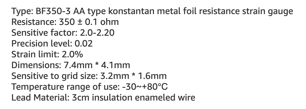

Hi thanks so much for you reply.
I bought these off Amazon and it does not seem like there is a datasheet linked but the site gives some of the specs:
Strain Gauges: DAOKI 10Pcs BF350-3AA BF350 350 ohm High-Precision Pressure Resistance Strain Gauge : Amazon.ca: Industrial & Scientific
HX711: WWZMDiB 4Pcs HX711 Load Cell Amplifier 24-Bit ADC Weighing Sensor Module Used to Measure Force, Pressure, Displacement, Strain, Torque, Acceleration. : Amazon.ca: Industrial & Scientific

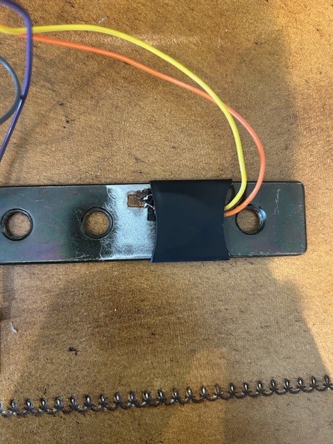

How is the strain gauge attached?

See attached the strain gauge setup. I've used regular super glue and soldered the wires on.
That why it is not working. All resistors in the bridge must be the same value.
regular super glue
That might work, depending on the actual bending of the metal piece but there are special glues for strain gauges

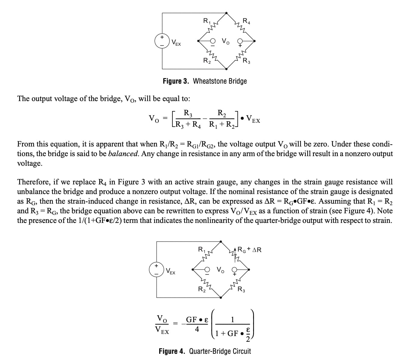

I would think that if you nulled out the delta-voltage with a pot it would be pretty linear....
...the resistance isn't going to change more than 2.0*2.2=4.4% or 15Ω/350Ω at the strain limit so the 2nd order effects would be in the 0.2% range. Likely good enough for a proof a concept.
Nulling the balance with a pot would be the biggest fix.
By using a half bridge like in the video, you eliminate the error by having both legs of the bridge be the same resistance, 330 + 350, so the output is zero with no load. With your quarter bridge arrangement one leg is 330 + 330 and the other is 330 + 350 so you get an output of approximately 14.7mV per volt of excitation with no load on the bridge. It's even worse in practice because your 330 Ohm resistors are not exactly 330 Ohm. That multiplied by the gain of the amplifier in the HX711 gives you the large output voltage.

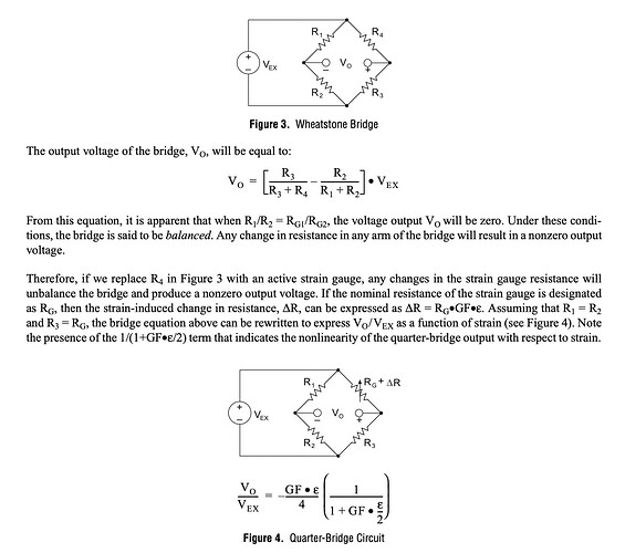

Actually, it might be just as linear--I think you get the same linearity with the pot adjusted to match the SG as you would if you used a matching SG--it is still the same ∆R of the SG in the same old voltage divider equation that induces the non-linearity. dig-dig...
(from http://elektron.pol.lublin.pl/elekp/ap_notes/ni_an078_strain_gauge_meas.pdf)
... ... If the pot was in R3 and adjusted to 350 ohms, the linearity would the same, even if R1 &R2 were 330ohms or 1000ohms. If you instead put the pot in R1=350 with R3 &R4=330, you could still null out to Vo=0 but the nonlinearity of the voltage divider equation would be amplified a bit, since the gauge is a bigger fraction of the divider. So with a smaller fraction, like R3=R4=470ohm, it would be attenuated.
