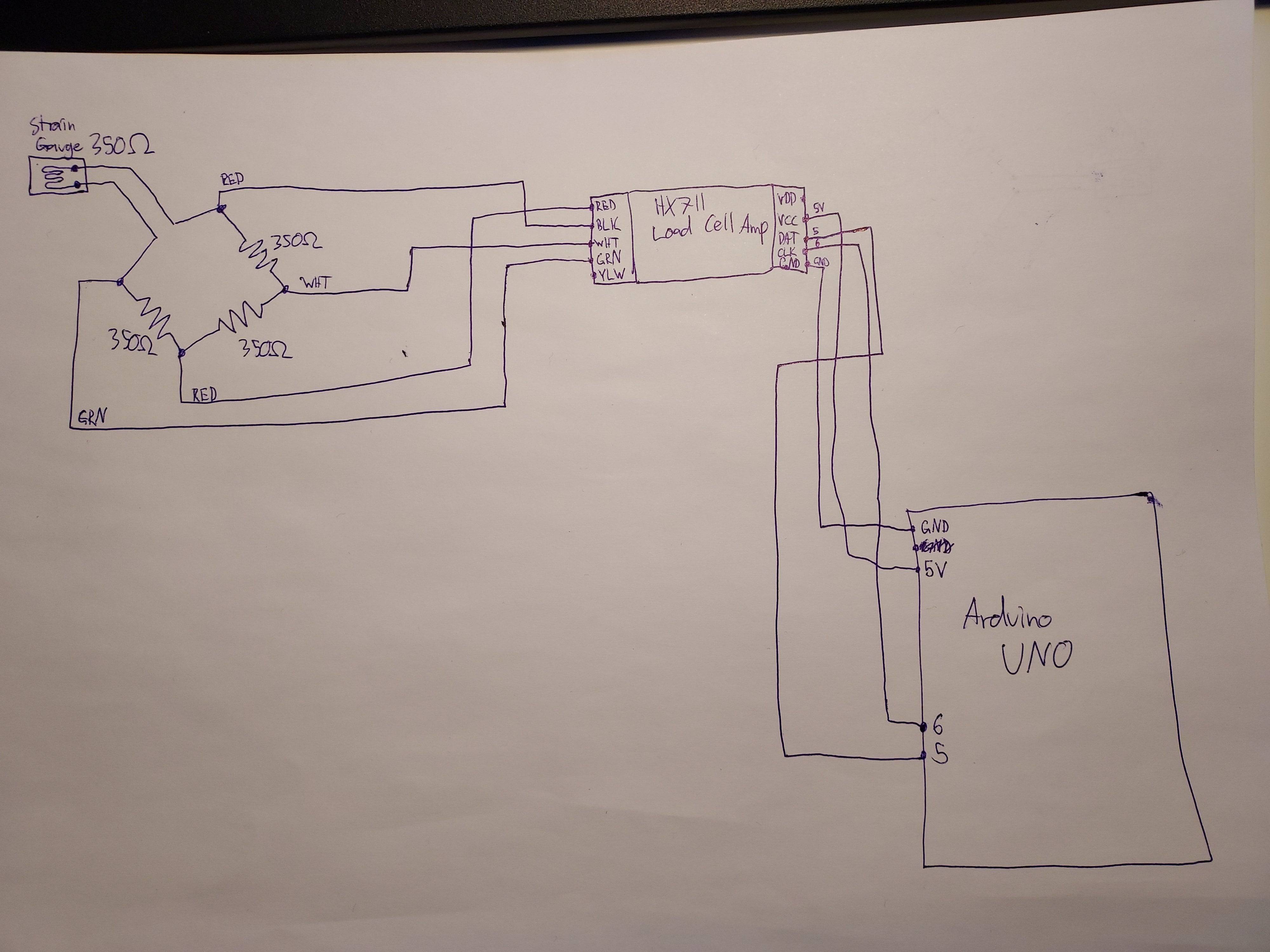

Hi there,
I am trying to get a strain gauge working with the HX711 load cell amp. I posted about this a few months ago and got told to get some high precision resistors for the wheatstone bridge. I have now obtained these (https://www.digikey.fi/product-detail/en/vishay-foil-resistors-division-of-vishay-precision-group/Y0007350R000T9L/Y0007-350-ND/2609877). My wiring and code are as shown below. I'm getting an entity too large error when I try to post the wiring image (even though it's under the size limit), but the wiring is basically a wheatstone bridge with one arm replaced by the straing gauge and each of the corners of the wheatstone bridge connected to RED, BLK, WHT and GRN on the red HX711 (BLK and GRN are the ones connected to the strain gauge arm). On the other side, VCC is to 5V on the arduino, GND to GND on the arduino, DAT to digital pin 5 and CLK to digital pin 6.

Circuit diagram?
MarkT:
Circuit diagram?
Hi Mark,
hopefully that link works for you since there's some glitch here that won't let me post images.
Cheers.
A Sparkfun HX711 board has two power connections.
One for the the analogue part and one for the digital part of the chip.
You seem to only have connected the analogue supply pin.
Leo..

Hi Leo,
thanks, I now tried shorting the VCC and VDD pins and connecting both to the 5V on the arduino, as I have seen in some examples, but it still doesn't seem to be working.
Cheers.
Measure E+ (Excitation voltage for the bridge).
It should be about 4.25volt.
Measure the two outputs of the bridge.
They should be about half of E+
Measure between the output of the bridge.
It should be close to zero volt.
Leo..

Hi Leo,
Excitation voltage is about 3.65 Volts when I measure it and the output voltage is about -0.04 Volts.
The arms of the bridge are all about 1.82 Volts, so half of the excitation voltage.
Cheers.
Multiplier7:
Excitation voltage is about 3.65 Volts...
Get that sorted first. It should be 4.25volt, ±0.05volt.
Check the VCC/VDD voltages, and check you voltmeter.
Leo..
