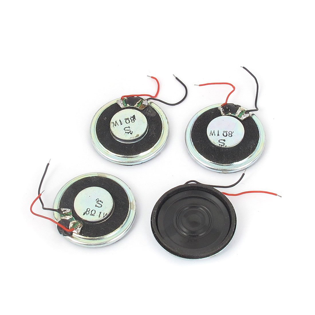

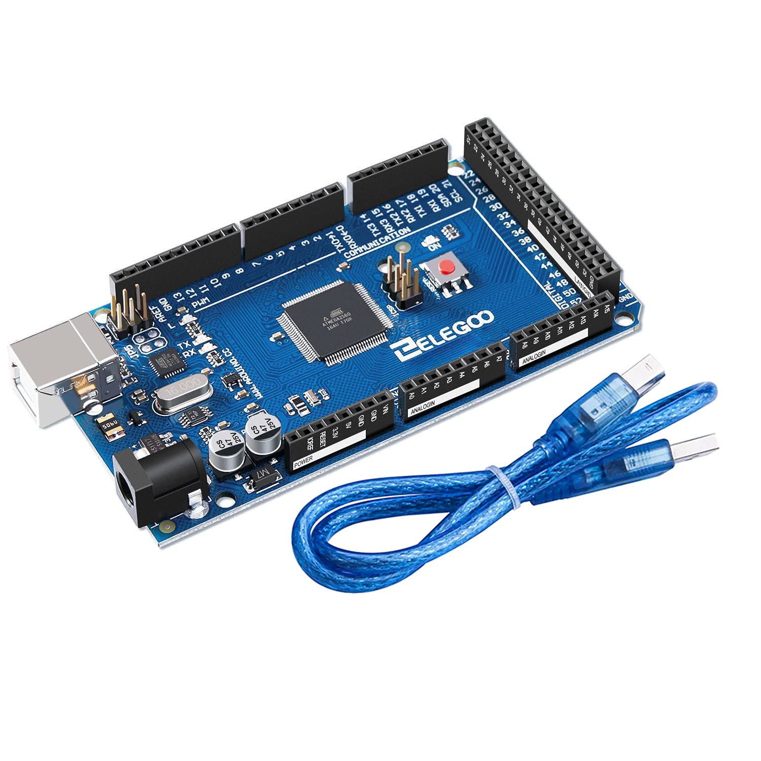

Is it possible to use the Big Sound Speaker when picking up the noise of a tap or a voice to have the similar noise be output to an audio sound speaker? If so, can I get some guidance on how to make this happen? My son and I are working together on ideas that are outside of the to-do projects that seem to already happen or are looking for other challenges that involve using the Arduino mega2560, board. Any assistance is much appreciated.

For the Speaker: https://www.amazon.com/gp/product/B019JMV0JY/ref=ppx_yo_dt_b_asin_image_o08_s01?ie=UTF8&psc=1

The easiest solution is powered computer speakers which can be driven directly from the "sound sensor's" analog output.
Otherwise, speakers are driven by a audio power amplifier.
You don't need anything digital for what you've described, and the basic Arduino doesn't have enough processing power for real-time audio and it doesn't have a DAC (so no true analog output).

https://www.amazon.com/ELEGOO-ATmega2560-ATMEGA16U2-Projects-Compliant/dp/B01H4ZLZLQ/
