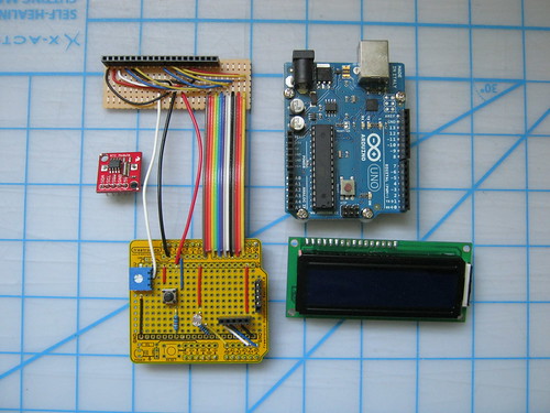

This is "BigBlue", a very simple clock using a DS1307 RTC and a 16-char/2-line (HD44780 compatible) LCD. The main features are:

BigBlue Pre-Assembly by funnypolynomial, on Flickr

The LCD I'm using has a nice blue backlight but it's very bright, especially at night so I added an LDR and code to adjust the backlight based on the measured ambient light. As well as the time etc, the clock's configuration screens allow the setting of "Lo" and "Hi" Ambient and Backlight values
- if the ambient light is less than the Lo value, the Lo backlight level is used
- if the ambient light is greater than the Hi value, the Hi backlight level is used
- at ambient light levels in between, the backlight level is interpolated
