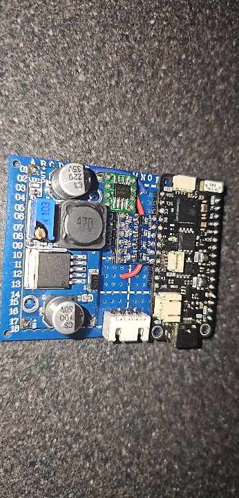

Also some photos for some of the things i managed to learn along the way :slight_smile:
My initial idea of using the USB KKL cable before i made my circuit ( mega + Relay for the IGN switch ) over RDP :slight_smile:
This was my early UART bridge, with sigrok
This was my v2 PCB ( Feather S3 )
Able to Fake the ECU to control the DASH
This is the TX, RX Pads on the Dash PCB,( they are the same lines used for the Kline bus) i was going to go this route, when i decide to upgrade the LDO on the pcb
finally this is my newest PCB, there is still room for the other L9637D, but I'm undecided how to progress further as of yet, I'm still finishing my code.
Cheers

Hello everyone.
I would first like to give a thank you to TriB and everyone else that have given input to this topic. I am trying to implement this solution and I will try to be brief on my explanation.
My setup is an Arduino Nano, HC06 and L9637D and resistors/capacitors to go along with them. The hardware works and I have managed to get a connection to my ECU.
However, I have found great difficulty in getting the software to work. I am not an SW engineer and I do nut fully understand how the code works. That being said, I have pinpointed my issues to this.
The OBD app sends request as 01 XX, for example 01 0C. I am able to respond to these requests with the emulator. Suzuki wants it to be 21 0C and I found that there is code for translation in the repo (HerrRiebmann/KDS2Bluetooth). If I interpreted the code correctly that translation is not called in the code anywhere and I am looking for a way to implement that.
My end goal is to have a device that can send live data to a device (camera or phone) and read and clear DTC. Here is what I have in the Arduino currently:
