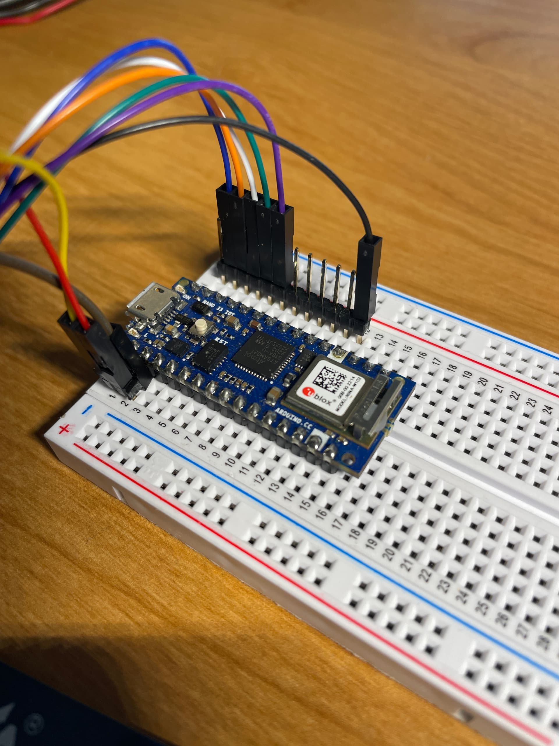

A Waveshare e-paper B&W 5.79inch connected to a Nano 33 IoT appears to be running setup() but with timeout issues based on the Serial Monitor output. The e-paper display shows no sign of life. Any recommendation on how to proceed debugging?

In GxEPD2_display_selection_new_style.h, here's the 5.79in related classes uncommented:

#define GxEPD2_DRIVER_CLASS GxEPD2_579_GDEY0579T93 // GDEY0579T93 792x272, SSD1683 (FPC-E004 22.04.13)
Here is the display <> Nano mapping: (triple-checked)

On the back of the display board there is a jumper soldered to the 0 side which looks to indicated 4-wire SPI.

DuPont connections may be bad, the white connector may not be pushed in firmly, or your soldering may be questionable. Post a picture, for experts to comment on.
Thanks. My bad on the GxEPD/GxEPD2 confusion. GxEPD2 library is being used. Added a couple pics.
Re connections - continuity checks out from breadboard to display cable PCB solder pads.
This line only defines that the display is Black & White.
You must find an entry that matches your pixels and the driver being used. It may be on one of the other display selection files.
Thanks @JohnRob - I picked the driver class below. Is there an additional one to look for?
I've not used any Waveshire displays, all mine are Good Display. However I know your choice must target the same driver IC as your display.
For instance, the one you picked uses a SSD1683 driver IC. Is this the IC your display uses?
Display is no longer blank. Had ordered B&W, but was shipped a 4-color e-paper display. Have changed class definitions accordingly.
