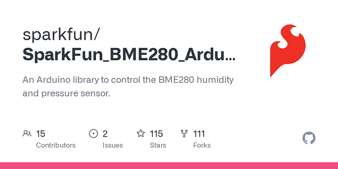

I used two web sites.
The first has a library:-
The second has an arduino example:-
http://www.winddeal.net/image/tools/40073%20GY-BME280.rar
