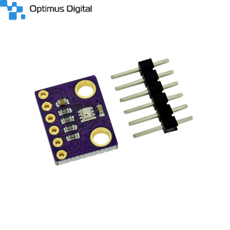

BMP280 GY on Arduino nano, I2C.
From internet, some say level shifting is mandatory, some say it might be the case, some say - no need.
I am very confused. I mounted BMP280 without any level shifting, using Senzor I2C library (the one dedicated to BMP280 from Adafruit refused to compile, despite changing the I2C adress and modifying cpp as well). The readings seems ok.
The question is: is it needed the level shifting in the of this sensor?

A level shifter can connect the voltage levels of SDA and SCL of a 5V I2C bus to a 3.3V I2C bus. Since data on the I2C bus is going in both directions, the level shifter makes a 5V signal from a 3.3V signal and a 3.3V signal from a 5V signal.
This BME280 has a voltage regulator for VCC and level shifters for SDA and SCL: https://www.aliexpress.com/item/3In1-BME280-GY-BME280-Digital-Sensor-SPI-I2C-Humidity-Temperature-and-Barometric-Pressure-Sensor-Module-1/32837354781.html. That makes it fully compatible with 3.3V and 5V.
When your Arduino Nano is powered with an external power supply, it runs at 5.0V, and you are operating outside the datasheet specifications when using the BMP280. That is not very bad, but you might get into troubles later.
When you power your Arduino Nano with a USB cable, it runs at 4.5V, and you are (barely) within the specifications.
On the other hand, the BMP280 and BME280 are very sensitive for high voltages at the SDA and SCL pins. The Wire library enables the internal pullup resistors, and that raises the SDA and SCL voltage levels.
If you have connected the 5V accidently to the VCC of your BMP280 module, the BMP280 is probably already broken (if your module is like the picture in the link you gave, that picture does not match the description below it).
If you want to keep the sensor happy, use a level shifter.
If you want to avoid troubles in the future, use a level shifter.
If you want to do what's right, buy a 3.3V Arduino board.

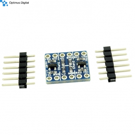

today I am going to buy level shifters (few types, as the Sparkfun one is indencently expensive).
https://www.optimusdigital.ro/ro/interfata-convertoare-de-niveluri/3389-modul-sparkfun-cu-translator-de-nivel-pca9306.html?search_query=SF11955&results=1
For a buck (see Tom Waits :-)))
or this one:
This one is around 3 USD:
They all claimed to be biderctional and looks like woirking on I2C. But I am not very convinced.

All your links are to I2C level shifters, and they all work.
The most common I2C level shifter is with mosfets. They work good. Some have 2 channels, some have 4 channels.
The special chips might be better, but I'm not sure about it. As far as I know, the mosfets are good enough.
Adafruit has both types, Sparkfun has both types.
I have the 2-channel modules with the 3.3V voltage regulator on the module. That can be useful, since the Arduino Pro Micro does not have a 3.3V pin.
