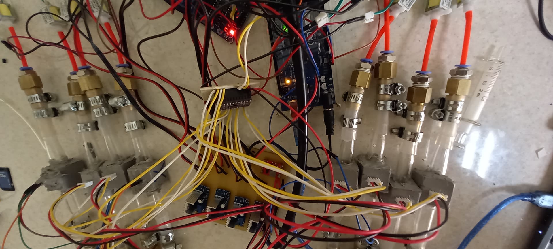

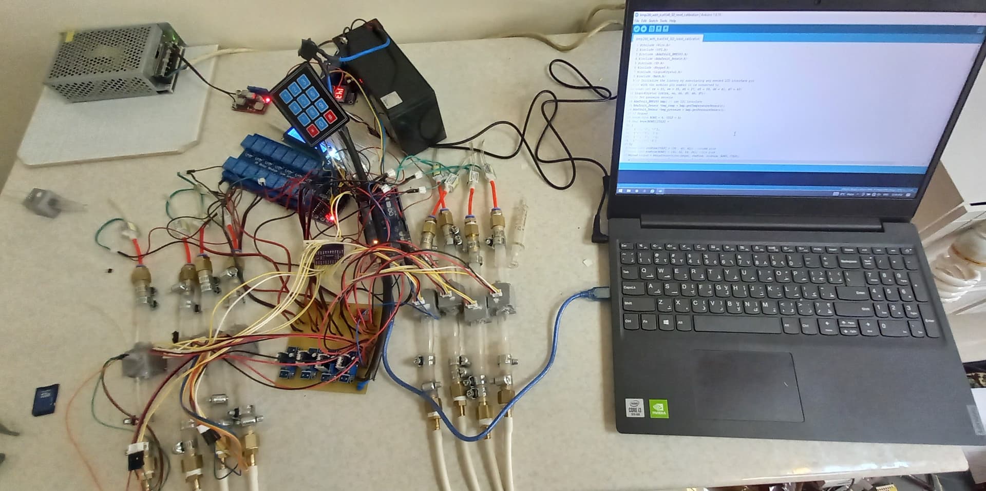

8 channels monitoring fermentation in 8 bottles. Each bottle is connected to a glass tube which is slotted. In that slot I placed BMP 280 for each channel connected to a TCA9548A multiplexer to record the pressure. The pressure in first steps are recorded and their average is registered as reference for future. When the pressure reaches a threshold, my Arduino mega2560 sends a signal to the relay for each channel and opens an electric valve and the pressure goes back to normal. The loop repeats.
Everything is alright except almost nothing. Bmp280s report varied numbers which regardless of my altitude from sea level, are irrelevant to each other. For example they report 881.0 and 1071 in the very same loop in a distance less than 30cm on my table!!! I don't really care about their numbers because I only want the difference from the reference pressure which I explained before. But the problem is they are not reliable too. In every 4 or 5 times that I start the device, at least 3 of them won't even connect, if I try to reset them to others also reset. Sometimes they don't even read. I should reset them to work again. Correcting all these flaws took me hours to write the code but still no success.
Do you think I chose the wrong kind of sensors? Do you have any suggestions for me to replace them with something else? Has anyone heard such problems from BMP 280 before? Any solution?

Can you please post picture(s) of your project so we can see your component layout?

I updated my post with the photos and my code.

The I2C bus has three wires: SDA, SCL, GND. I can not clearly see where the black GND wire is going.
In the sketch, each sensor needs its own object. I only see one 'bmp' object.

The GND goes to the power supply and all the GNDs are connected to the Arduino GND. Also Arduino power is supplied by the same source but different voltage regulator (9volts).
