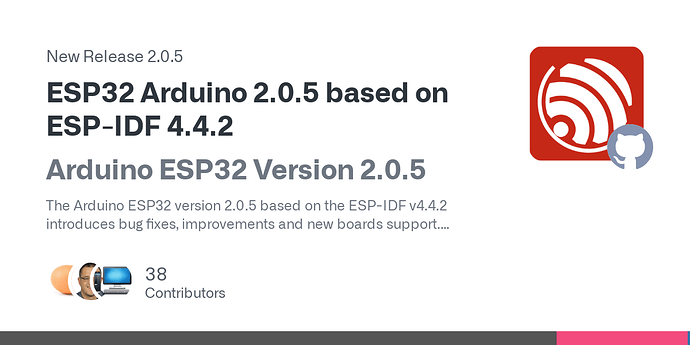

Currently have ESP32 from Espressif version 1.0.6 installed and have used that ok in past projects with ESP 32 Dev kit boards
Now looking to use an S3 board (based on YT's linked below)
His videos show an upgrade of that ESP32 library to 2.0.5 which I assume includes the S3 board
I can see no references to S3 board using 1.0.6
In my Board manager ( 1.8.19 & V2.0.2) shows version 1.0.6 as the installed version of EPS32 library and doesn't offer any update button and in the drop down 1.0.6 is shown as latest version
Yet the YT video shows him being offered later versions up to 2.0.5
Yes - I think there is a problem with the links he has provided
The one shown in the video gives a 404 error
and the one he links to in the video description refers to an rp2020 which I think is a PI device so must be wrong
Hi @bob_a_builder. Espressif changed the URL some time ago and stopped updating the file at the old URL. You can learn the new URL by checking Espressif's official documentation here:
That URL is intended to be used by those who are contributing to the ESP32 boards platform project by doing beta testing. If you only want the stable version for ordinary usage, you should use the other URL provided at the link I shared.
