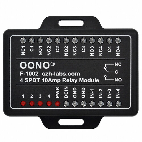

Well, that module doesn't have on board driver transistors for the 35mA coils so you will have to supply and install them yourself. MCU output pins cannot supply that current.
The relay board you linked to will do fine in either 5 volt or 12 volt relay coils. I should have mentioned those boards include the flyback diode (1N4002 in my drawing) and a LED to let you know which relays are active (energized). You will still need the transistor driver since the DIO pins on the uC can't supply enough current to drive the relay coils. The 5.0 VDC coils draw 106 mA with a coil resistance of 47 Ohms and the 12 volt coil versions draw 43.6 mA with a coil resistance of 275 Ohms. Either way you need a driver. Also as mentioned you need an independent power supply of 5 volts or 12 volts.

And when we say an independent power supply, we're talking about a power supply to power the relay module? On the input side?
I would like to use the boats 12 volt electrical system for as much of the power supply as I could?
Ok, so this looks like an all in one for me?

With this, would i use the 12V system on the boat to power the module, "Operating Voltage" and on the "Control signal input", use a digital output "High" to activate? Does that sound accurate?
An Arduino or ESP can drive this product directly from a GPIO output to the "Control Signal Input"?
Yep, here is what you have:
Each relay uses a transistor "Darlington Pair" to drive the relay coils and includes a LED which illuminates when the relay is active and yes the inputs will be a logic high.

The same outputs which drive your 8 relays can have an LED on them so with 8 relays all you need is 8 outputs including LEDs. Your relays are SPDT (Single Pole Double Throw). Each relay has a Com, N/O and N/C contacts. Since you are only using a relay to switch 12 volts and will be using the Com and N/O contacts you can actually use the N/C contacts to run a LED telling you the relay is not energized so all you need is 8 outputs from a uC.. Hell your post #26 shows your choice of relays have a LED telling you the relay is energized, see my post #27 shows the diagram of your chosen board. Eight relays and eight digital out pins is all you need.
