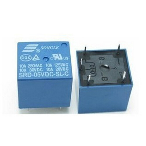

relay songle srd-05vdc-sl-c 10a
I have 5v relay songle srd-05vdc-sl-c 10a
wemos d1 board.
I would like to control 12v solar lights.
Can I use my relay for testing Safeway?

Do you mean that at the moment you already have just the "loose" relay like this:
... and you want to know if / how you can use that while you are waiting for this one?
I have relay 2 can use it whit 12vdc?
The 5V in big letters "05VDC" means it needs 5V to energise the relay coil. The smaller writing "10A 30VDC" means it can switch 30V. (Although I have no idea why it also says "10A 28VDC")
So can I use it to test 12vdc lights?

I have no idea what a wemos is, but this diagram I found out in the ether is how to do it with an Uno. Bottom right is your 12V supply, top right is your light.
The light is connected to the COMmon and Normally Open terminals, so when the relay is energised, the contacts close, and the light will come on.
For exactly the same reason it says "10A 250VAC 10A 125VAC". :grinning:

It should work just fine powered from 5 V and controlled by the WeMOS. The usual concerns about grounding and supply layout and bypassing apply.

yes. but you need to provide more information.
the relay board you linked to requires 5 volts for the coil.
the relay can switch the 12v you have for the load.
a relay is made up of 3 parts.
the CONTACTS. these are isolated, labeled NO COM and NC
these act just like a switch. the are not connected to your Arduino.
the relay is printed with the ratings that the contacts can handle.
10A 250VAC is one load that it can handle
10A 125VAC is also possible
10A 30VDC in case you have a DC load
10A 28VDC is the last rating for the CONTACTS.

The second part of the 3 is the COIL
the manufacture picks the coil voltage. you posted a link to a relay that uses 5 volts for the coil
the coil needs to have a separate power supply. never feed a relay the power for the coil from the Arduino board.
using ONE relay might be fine.
the relay coil pulls about 80mA
So you're saying that it will not cause a problem if I temporarily use it for testing?
I just do not want to damage my relay for Arduino clone.

the CONTACTS are just like a switch.
if you connected a switch to your LED's would that damage your Arduino ?
you might ask, how they are connected......
the answer is they are not.
once you can grasp that the contacts have nothing to do with the logic, and you can use 230 volts AC on the contacts, or 1 volt DC, it might become more clear.
the CONTACTS have nothing to do whatsoever with your logic signals.
#2) a coil, in this case, an electromagnet, is the coil that is the large part of the relay.
the coil requires power. the manufacture tells you the voltage needed.
that voltage is only needed to operate the coil. the coil voltage has nothing to do with your Arduino board. when you charge a coil, it uses a LOT of power and can cause the line voltage to drop.
when you allow the coil to discharge, it can dump a LOT of power back onto the line.
this is why your coil has nothing to do with the logic control of your Arduino.
it is why they use an opto-coupler
in the case of the single relay, only a transistor and that is not isolated by anything but the diode of the LED.
#3) you Arduino output can only go to the LED, then the resistor, then the transistor.
if you power your relay from a separate power supply, then only the signal and grounds are shared.
if you take power from your Arduino in the 5 volts, then you have connected power to the board.
the relay has a diode that should prevent any spike, so the chances of damage are very tiny.
see the wiring in post #6. this should work.
but it has to be 5 volts power to the ( + ) connection.
connect the ( - ) to your ground and the ( s ) to your output pin.
you will hear the relay click off an on as you toggle the output.
