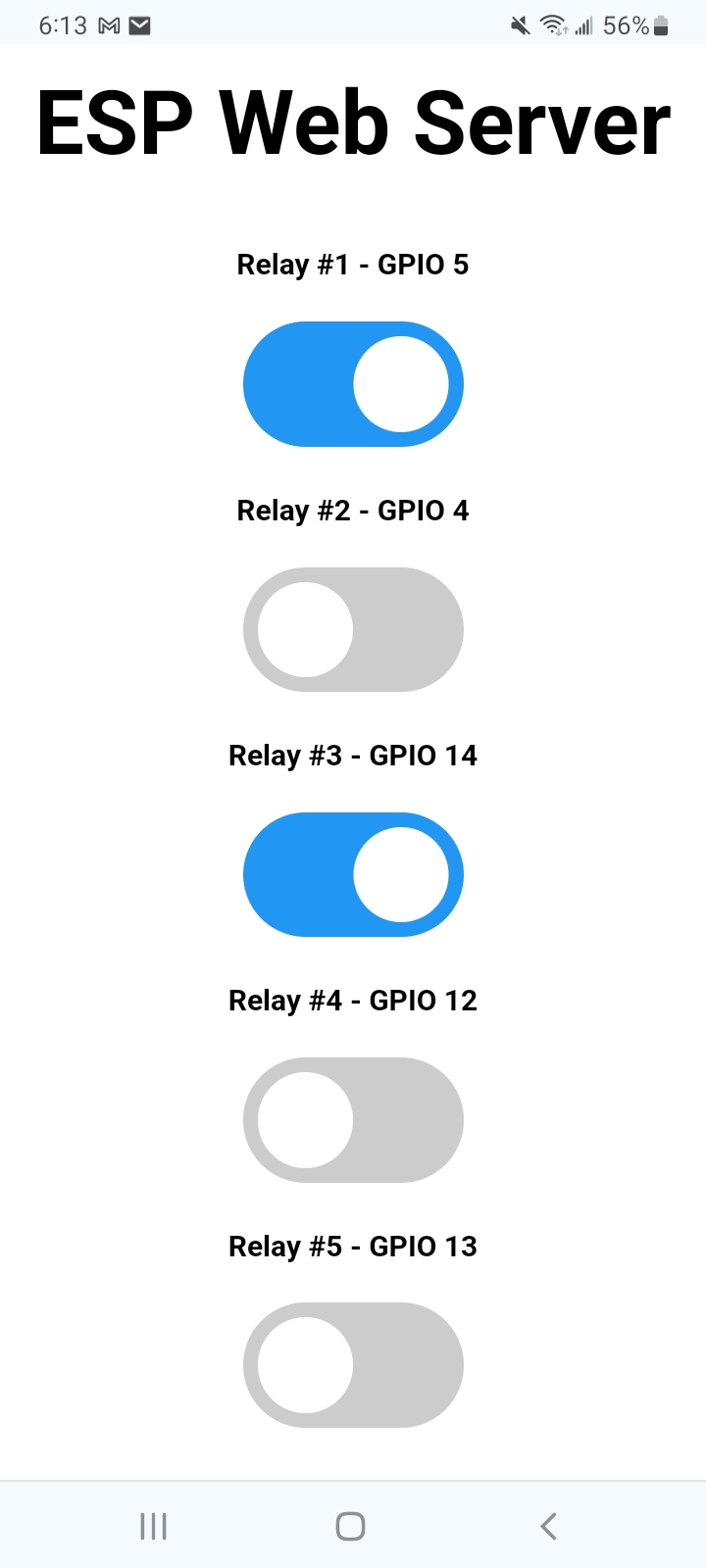

Since you mention using a phone to control relays I would suggest you first give this a read. There are other wireless solutions but for starters the ESP8266 would be a good choice. The link starts out simple with a single relay and advances to multiple relays. I am guessing something like this is what you are after.

Again, everything I am posting is about remote control of your relays and assumes a network connection. You control the relays through a PC or using a smart phone so it looks like this:
How it shows up on my phone. Relays can be added or subtracted. This is merely an example. Now if you just want to turn relays ON/Off using for example buttons it gets much simpler. :slight_smile:
