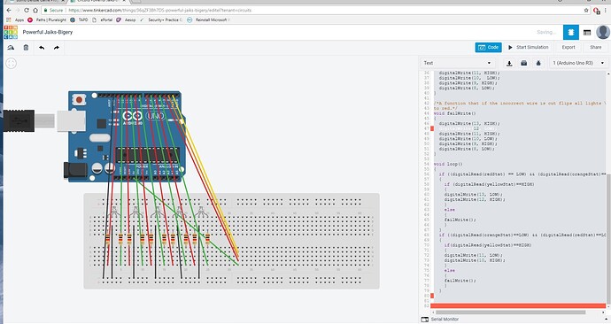

First time posting and Arduino newbie. I am currently working on a project for an escape-room type puzzle where the players have to defuse a fake bomb by cutting the wires in the correct sequence.
I have been using Tinkercad to build a proof of concept but am having some issues with the code; specifically building a conditional with multiple layers. I have some programming experience with Python but I am new to Arduino's.

I have attached a graphic of my wiring as well. I know my logic is off because when the red and orange wires are cut, red goes back to red but orange stays green. I am not sure how to build a function with multiple conditionals that would satisfy my requirements (some kind of nested function maybe?) If there are any tips you can give in regards to my logic or even my wiring it would be greatly appreciated. Sorry for being a noob!

It appears that you have all your Stat wires connected to 5V and declared as INPUTs. When you "cut" one of those wires, the input is neither connected to 5V or GND so who knows what the state of the pin will be when you read it.
What you need to do is connect them all to GND and declare them as INPUT_PULLUP and then change your logic around such that reading the pin as LOW means it is connected and reading the pin as HIGH means the wire has been cut.
You also go do the trouble of declaring your pins as variables at the beginning of the program (GOOD)
(Note: they should be 'const int' since they never change)

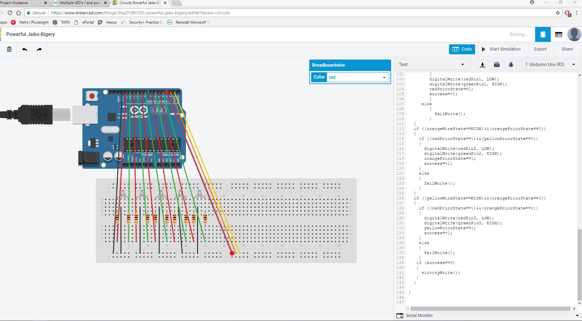

Updated my code as per your recommendations, thank you for the input. Thanks for your patience with my rookie mistakes.
Also changed my wiring as per your recommendations. I will test when I get home as I have been working with this simulation while at work. My hope is as long as this works currently to expand it to 5-6 wires. As it stands currently are there any potential glaring issues having made the change to INPUT_PULLDOWN? Not 100% sure I incorporated that correctly as my simulation seems to be acting funky compared to how it did before. Thanks again for your input.

Now you have pin 1 going to ground.
This can blow up your Arduino.
Pin 1 is the serial transmit pin.
At power up this pin is set as output.
If you connect pin 1 to either +5v or 0v you will blow the pin, but this is a bomb so maybe you want this to happen. :wink:
BTW, you can use A0-A5 (14-19) as digital inputs or outputs.

What do I need to change in terms of my wiring? Am I incorrect in grounding them like that or should they be how they were before? Glad I did not test it that way when I got home.
Suggest you put input pins like this to GND through a minimum of 1K.
Arduino pin ———— GND <——-<<<< No!
Use a resistor:
Arduino pin ———— 1K through 10K ——— GND <——-<<<< Yes
Thanks all for the help- with Larry's wiring advice everything is working like a charm this morning. Thanks for helping a newbie.
