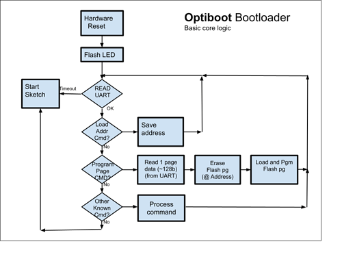

You won't find the conversion from intel hex frames to flashing process in the optiboot source - it takes STK500. AVRdude parses the hex file and sends STK500 programming commands to the bootloader, which goes from that to flashing commands.
There are bootloaders that take the hex frames though - chipboot45 does, for example. Unfortunately, you have to pay to get access to the chipboot source code to make custom builds or see how the code works (it's targeted for industrial applications, where the fee is no big deal).
  1. Assuming those are the right fuse values (too lazy to check). You can also use an ICSP programmer (arduino as ISP, USBAsp, etc) to do this programming; doesn't need to be parallel.
  2. Yes.

You had asked where the bootloader source of the Uno was so I pointed you to that but if you're going to be delving more deeply into optiboot I recommend you to use the latest source:
There have been some changes made since the version included with the Arduino IDE. The Makefile found at the above link is set up so if you put the source code folder in {Arduino IDE installation folder}/hardware/arduino/avr/bootloaders/ the makefile will be able to find the AVR-GCC tools which are included with the Arduino IDE. The folder structure of the IDE has changed since optiboot was added to the Arduino IDE so the optiboot makefile included with the Arduino IDE does not work correctly but the up to date optiboot makefile has been updated to work with the new folder structure. You also need make, which is no longer included with the Arduino IDE so you will need to install that. If you're using windows you will also need rm. Then to build the bootloader you just need to run:
make atmega328
from the folder that contains the optiboot source.
There are also many other targets supported by optiboot.

the working principle of the Boot Loader Program in respect of how it collects Intel-Hex frames of an application sketch
As DrAzzy mentioned, Optiboot doesn't contain any code that deals with "Intel Hex Format" - that's handled by the avrdude program on the PC side. GitHub - WestfW/OptiLoader: Arduino sketch for burning new bootloaders has code that parses Intel Hex, if you're interested...

    You have misunderstood. AVRDude parses the intel hex file, and sends STK500 programming commands over UART serial with TTL voltage levels. There is no RS232 - RS232 means +10/-10v voltage levels, TTL is 5v and 0v. Many people mistakenly refer to TTL serial as RS232; don't be one of those people
  2. My understanding is that there must be a Communication Controller on the Arduino UNO Board to
    receive these frames, extract the binary codes and fuse them into the Application Flash of the target
    MCU (ATmega328 of Arduino Kit) as per Serial/Parallel Programming Algorithm of ATmega328.
    No. The bootloader running on the '328p receives the STK500 commands, and translates those into what's required to write to the flash; this is simpler than processing the intel hex frames
  3. There is no such controller like Step-2 on the Arduino UNO Kit; rather, there is a USB <---->RS232
    Converter Chip (U3, ATmega16U2) on the Arduino Kit, and it communicates with the existing
    ATmega328 over USART Port.
    Huh? Also, see above, it is a USB-serial adapter, it is not RS232
  4. Therefore, there must be a Boot Loader Program within the Boot Section of the existing
    ATmega328, which receives the Intel-Hex Frames from the Host Computer and fuse them inside
    the Application Flash using Self-programming algorithm.
    See 2 above, it receives STK500 commands, not intel hex frames.

You could also look at how Nick Gammon's code tha reads & extracts data from .hex files for loading a sketch into a chip.
I run his code on my board in this '328P based standalone programmer I offer. The '328P reads the .hex file contents and loads them in the target microprocessor over the SPI pins.
http://www.crossroadsfencing.com/BobuinoRev17/
Does this help any?
Does this help any?
It is a lovely Flow Chart. I have a very special fascination on Flow Chart as it always helps me (perhaps many others) to represent problem solving steps of a complex process in a pictorial way using few pre-defined geometrical figures. A Flow Chart allows viewing at a glance the totality of the solution of a problem. The developer is relaxed seeing the solution, he was painfully carrying in his head, is just on the Table by virtue of the Flow Chart. I, for the first time in 1979, saw Flow Chart of a 'Urea Production Process' of a Fertiliser Plant in Bangladesh being built by Foster Wheeler (UK).
Anyway, I hope that I will give a try to convert your Flow Chart into workable codes (perhaps in ASM first and then in Arduino C) and then test them using RMCKIT/AVR Studio 4 and Arduino.
I am posting below a Flow Chart which parses Intel-hex frames, coming from a Host Computer, and stores the code/data bytes into Flash(Code Memory)/EEPROM (Data Memory) of a target ATmega32/8 using Serial Programming Algorithm.
(How could be that the image you have posted has a very good resolution than my one. I make diagram using Visio, and then paste it into Paint and then save as *.png file.)
GolamMostafa:
If you mean why is it so small and hard to read, the forum scales the image down to a maximum width. If you right click on it and then select View Image you can see it in full size. The smaller text on the right does look a bit blurry though.
