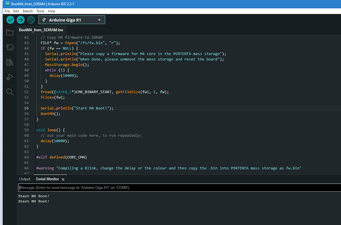

I have tested with example: RPC > BootM4_from_SDRAM
Seem M4 wont boot after first power on (even tested with RPC.begin() / bootM4()).
I need to press "Reset" on the board at least once to make M4 boot from SDRAM.
I do anything wrong? not modified example code, just add serial print before bootM4()

I try myself, after add SCB_CleanDCache(); before call RPC.begin() / bootM4() the problem are gone.
M4 core now boot without pressing Reset. but I try remove CleanDCache, it's happened again.
I dont know it's related with cache or not.
