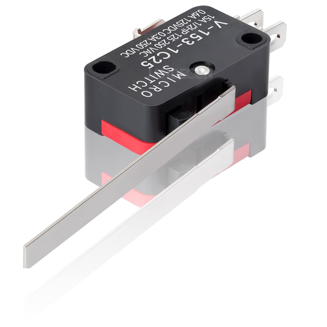

The way I have this laid out is Arduino B is married up to a keypad and a has an LCD for seconds down to 2 decimal places. It also has rolling digits. Put in 1.58, press 0, becomes 5.80. * is a clear function, and # sends the integer group to Arduino A to input for the timer as milliseconds.
The top button ("Trigger") will be a micro switch inside the top of the press that will activate when the ram is raised, bringing the case into the annealer coil. Once triggered, the 120VDC induction coil will activate via relay (simulated on TinkerCAD by a lightbulb) for the amount of time sent from Arduino B's keypad and then shut off even if the ram is left in the up position. I didn't want the loop reheating the same case if left for too long. The relay completely isolates the induction coil from the loop until the system is reset.
Bringing the ram into the down position, and cycling in a new brass case, will trip another micro switch at the bottom of the stroke ("Reset") which unlocks the trigger pin again as well as doing a plus up on the case counter on Arduino A's LCD.
The ping and pong of the micro switches can continue up to 9999 times to have a solid count on the LCD if one chooses, I never batch more than 200 pieces of brass usually, but I like symmetry, hence why the counter is 4 digits and 6 blanks on either side.
Once you are satisfied with the count, there is another button ("Reset") that is next to the light bulb relay on TinkerCAD, and will just be mounted on my press station for real, that will clear out the count and bring it back to "0000".
Have noticed that it runs an little slow currently and the buttons need to be held in order to move along the program, but I can't confirm if that is issues within the code or just my computer and internet match-up.
I will soon be actually building this so if there is a glaring issue, please let me know what to address before I put it to perf/PCB. The actual device will likely be with Nanos.

You might want to do some research on state machines, that is a common way of implementing tasks like this. Also look into detecting when an input changes state, as opposed to basing your actions on the current state (HIGH or LOW) of an input. Button de-bouncing can also be important, but I don't see a need for that in your code, because of the other time-consuming code in loop().
You have a fairly straightforward sequence of events:
1 > wait for "reset" switch to transition from active to inactive (indicating lever is being raised)
2 > now wait for "trigger" to transition to active state
3 > activate annealing coil
4 > wait for completion of annealing and deactivate coil
5 > wait for "reset" switch to transition to active state
6 > increment counter
7 > return to step 1
During step 1 would be the time when you are checking for any keypresses on the keypad, in which case you go into a separate sequence of steps for entering data from the keypad, again returning to step 1 when data entry is complete.
You could also store the time value for the annealing coil in EEPROM, so that you don't have to re-enter the data every time you power up the Arduino.
