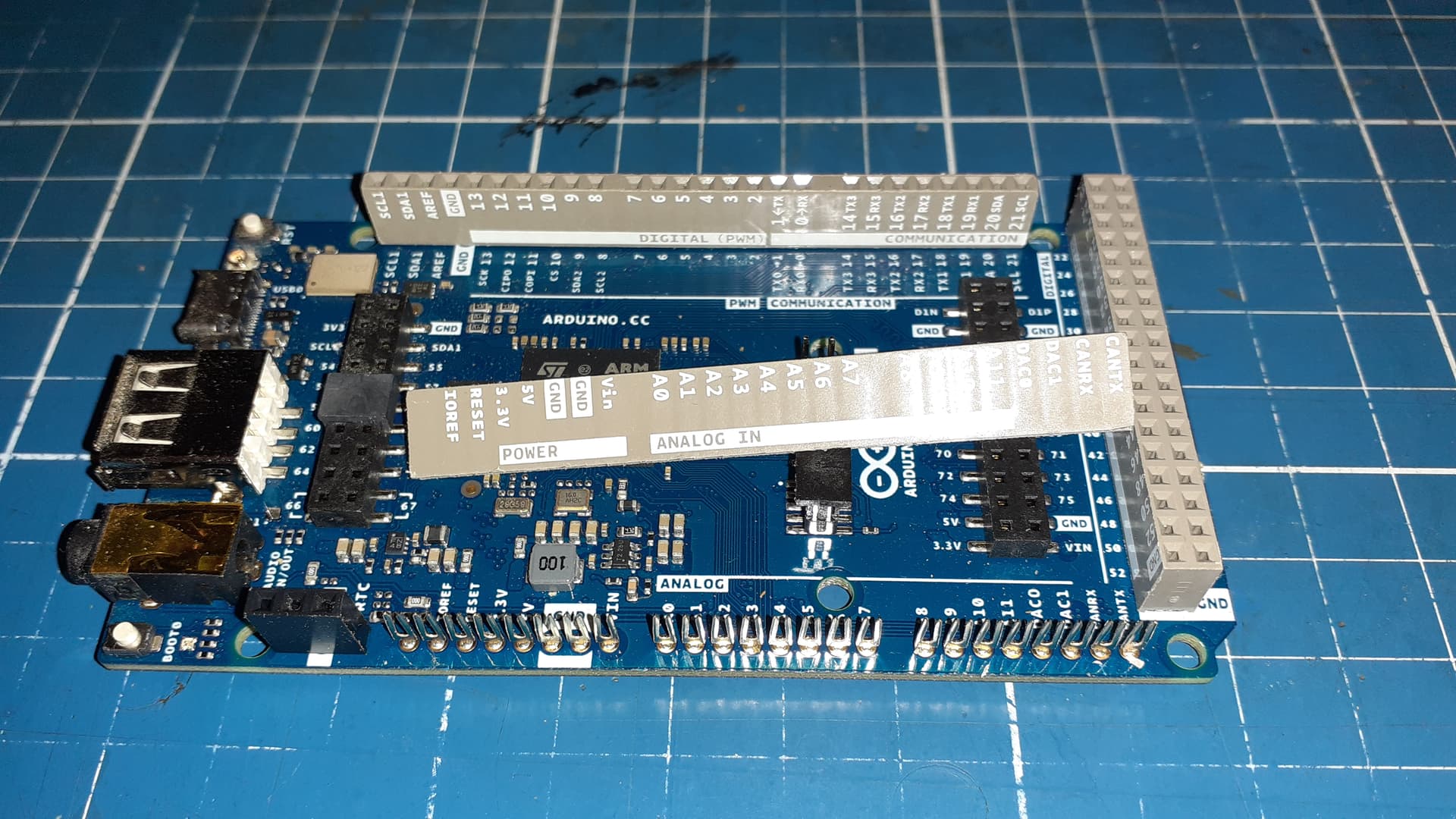

Broken male pin in Giga gray female header
Has anyone had any luck removing a male pin broken off in the gray female header 3.3v labeled power on the right side as looking from the audio jack side. I saw people prying the header of the uno with the black header. Anyone know if this works with the gray headers(the seem to be on pretty tight)? or another method
Thanks
The header sockets just push fit over the female pins. Snug, but not fixed. Flat blade under one end and lever up a tiny amount, then the other end, repeat until clear 1mm and it'll probably pull off. GIGA no different, other than colour.
popped mine off just to demo. (may be a little tougher with a pin in.
p.s. with the longer headers you need to work your way along rather than just at the end
Thank you very much for the information. It worked like a champ !
