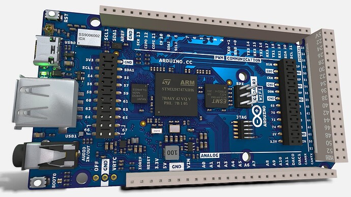

Arduino Giga R1 module. I was going to see if I could re-pad it.
Do you mean this one withe pads labeled OFF, GND, and VRTC?
Yes.
And why is it you don't want to put a header there? You could solder wires if that was more convenient for you. If you need to remove some solder from the holes you could follow the suggestions in post #2.
I tried to put a 3 pin header.

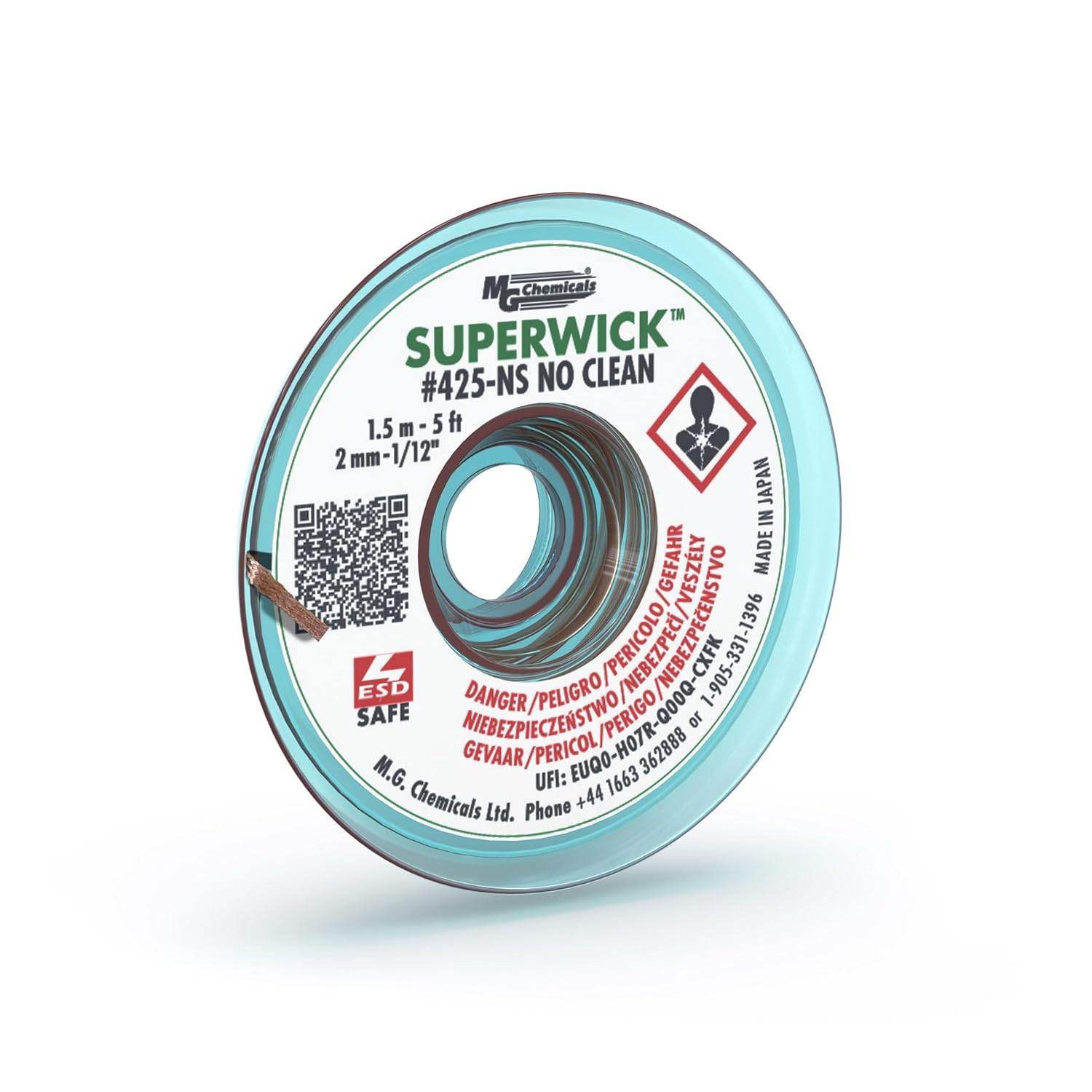

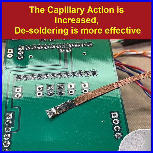

PE - I was looking at youtube and didn't see anything demonstrating clearing a through hole with desoldering wick (braid). It's a simple proposition, place the wick over the hole and press down on that with the hot soldering iron tip till the solder wicks up the braid. (Is that capillary action ?) It's not "intuitive", but adding some new, fresh solder, beforehand, can help.

I have a solder sucker and solder wick. I will probably replace them. I am ready to get a better solder station.
LarryD, thanks for the pictures and ideas.

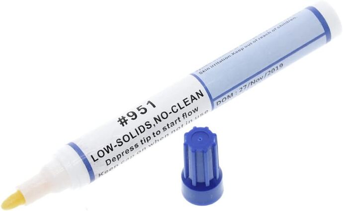

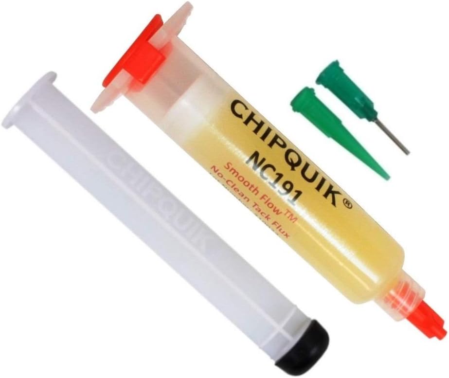

  • Invest in soldering flux paste and a flux pen, always use it.
