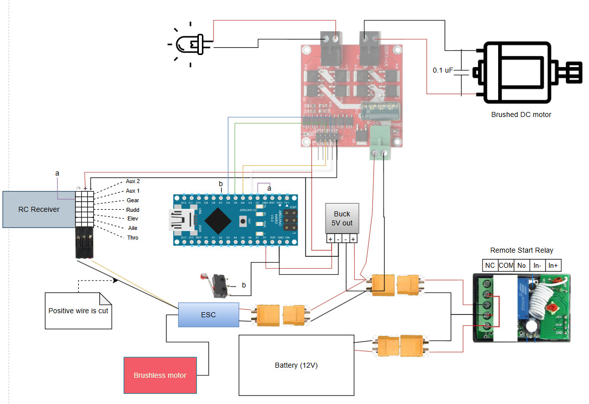

I am working on an RC submarine with an Arduino controlled ballast pump.
The goal: to control the ballast pump with an RC transmitter through the Arduino.
The problem: there are interruptions that cause the motor to hitch when running in one direction and not the other.
My hypothesis: arcing brushes in the motor cause some sort of interference with the Arduino.
Here is my wiring diagram:

And here is an example of what the interruptions in the serial plotter looks like:
Relevant Parts List:
  • Mateksys MBEC6S 5v Buck Converter
  • Gikfun 12V DC Dosing Pump Peristaltic
  • DROK DC Motor Driver, L298 Dual H Bridge
  • JR 70 MHz Receiver
  • Arduino Nano (Official)
What I tried: I tried adding a 0.1 uF ceramic disc capacitor across the motor terminals to mitigate electrical noise. There seemed to be no effect and the issue persists. I also tried twisting the wires leading to the DC motor.
Observations:
  • The RC receiver can run servos and a brushless motor with no issue even while these interruptions are happening. I think it's safe to say the receiver is not the problem.
  • Interruptions cease when disconnecting the motor.
I am looking for ideas on how to fix these interruptions. I'm willing to try different solutions and answer any questions you have. I am an amateur Arduino creator and I look forward to learning about best practices.
I'm not sure how you see/feel/sense this "hitch".
So if you just connect motor driver pins to HIGH/LOW or LOW/HIGH without arduino, does it misbehave?
Does the posted code actually demonstrate the motor problem?
Test the motor with the simplest possible code that will make it run forward and backward.
The dips are timeouts in pulseIn(), and are meaningless as measurements.
Switch to brushless motors. Change ancient L298 for modern MOSFET design.
Somehow get to the metal frame of the motor and ground it to the system ground. It will be your best shielding for arcing of the motor brushes.

To clarify, the motor "hitches" when it suddenly changes direction during one of these interruptions. In other words, the PWM jumps to 0 momentarily and the motor suddenly changes direction as a result

I wrote the following code to run the motor in both directions:

The motor ran in both directions without any interruptions.
Thank you for your suggestion! I soldered the ground terminal on the motor to the case and the issue persists.
Thank you for the suggestions. I will look into this.
It must go directly to your system common ground, not through a bunch of circuit boards and connecting wires! You do have a common point where all grounds are connected, don't you?
Your code posted here doesn't use pwm.
If pwm goes to zero, it doesn't change direction of motor.
You didn't answer how it behaves connected directly to HIGH/LOW.

I see now what I did wrong. I will connect the motor casing to common ground and try again.
