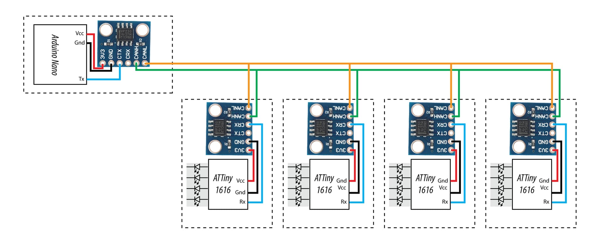

Is this what you were suggesting? It would be great if something like this would work.
(P.S. I know I'm missing the termination resistors and the signal ground in this diagram and please disregard the error on the power connections on the last 3 ATTiny1616.)
if you consider to add a module to each node, why not a good old RS485 Bus?
About 100 receivers and they are 1.5 meters from the Nano ? Maybe the TX is enough.
If you power the Nano board via the USB cable, then it runs at 4.5V.
Suppose you have the Nano running at 5V, then the TX pin changes between 0V and 5V and can drive (more than) 40mA. That is a lot.
A driver chip might even be weaker than the Nano output pin :scream:
You could add a protection resistor of 150Ω in the TX line, depending on the cable and the circuit that you use. With that resistor, you have to lower the baudrate. That should be no problem, the default of 9600 is already very slow :snail:
This would be my first option, my second option would be daisy-chaining. With a daisy-chain, it is possible that each of the 100 receivers can send a message back. My third option would be RS-485.

It could be up to 150 meters ? Then RS-485 is a good option. There are cheap modules of 1 euro/dollar each on AliExpress. I don't know about their resistors and if they still work with 100 nodes.
For daisy chaining, you need a RX and a TX signal from each ATtiny. If a wire breaks, then the rest of the chain does no longer work.
I think that you should consider the time to solder/connect everything together. If you can cut the hours in half by spending twice as much money, it might be worth it.
