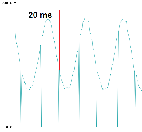

For the missing tickmarks I found this workaround:
at certain times (e.g. every 0.01 second) send the value "0" instead of the actual sample value.
It does not look very nice, but it enables you to analyze the signal.
The screenshot I appended shows the input of an open A0 line getting the mains humming,
and you can easily determine I live in the 50-Hertz-area.
