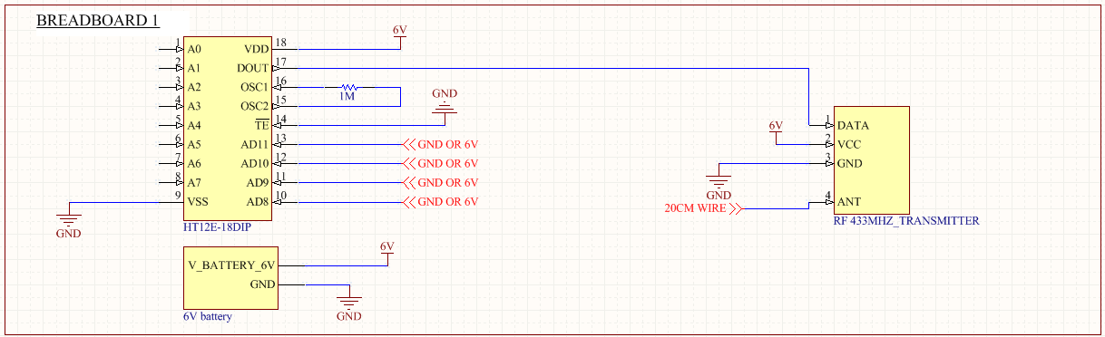

Build a remote control car from ground-up without a microcontroller! In this series of videos, we will outline a step by step tutorial on building a remote control car.
In our first video of this series, we will look into controlling LEDs using an encoder/decoder pair. Schematics is shown on the image attached.
This video is live on Youtube: - YouTube

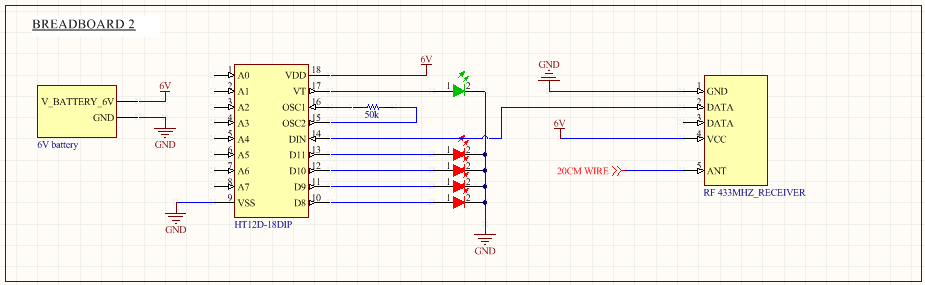

In our second video of the build your own remote control car without a microcontroller series, we will look into controlling LEDs wirelessly via 433MHz radio transmitter/emitter pair.
The video is live on Youtube: - YouTube
