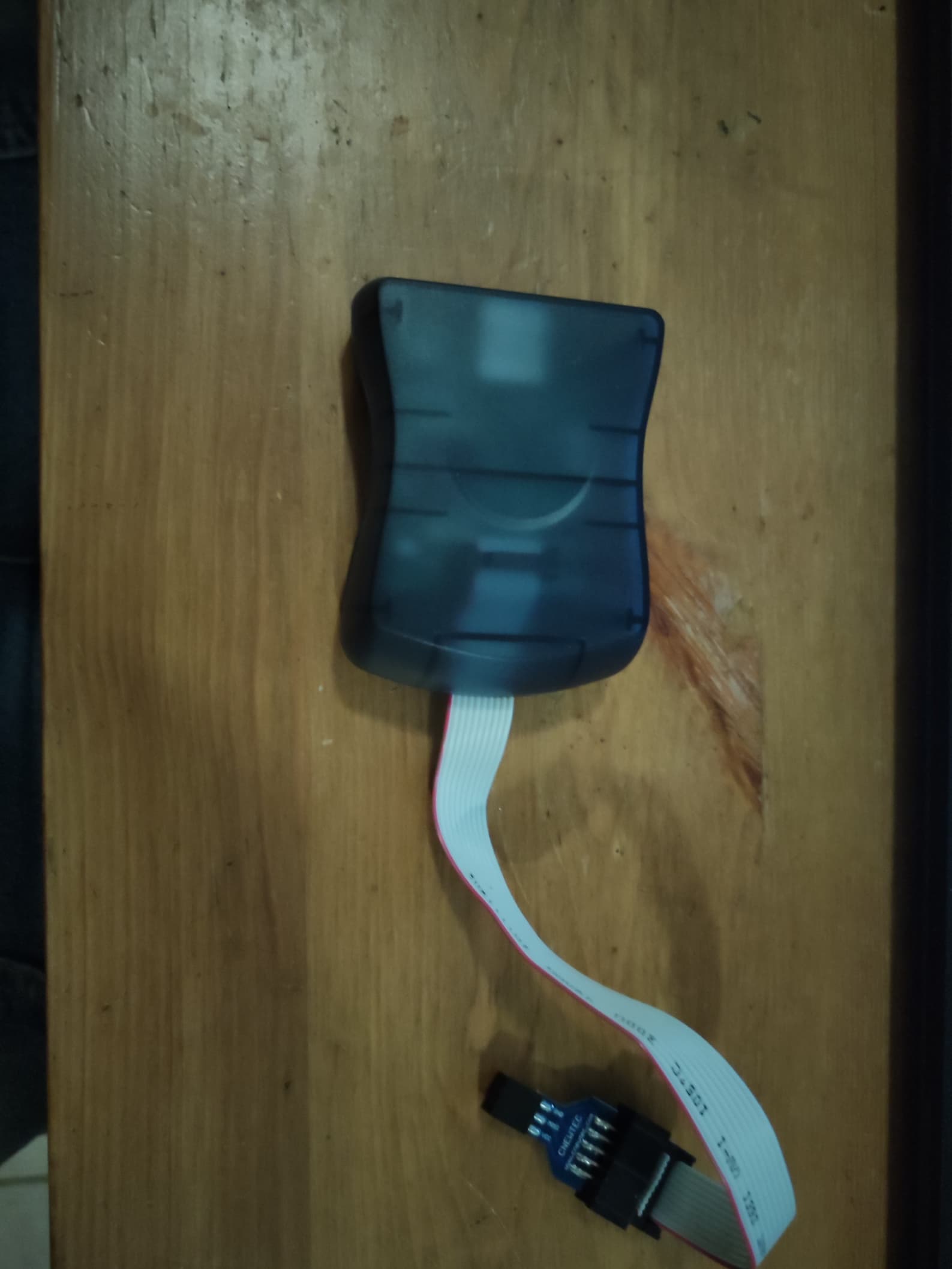

Hello, i built up my new leonardo board. I Placed a Atmega32U4 and it's usb connector. Then i flashed in the bootloader for arduino leonardo with AVRISP mkII programmer and found out when connecting to the pc through it's usb connector windows does not reconice it. How can i do to solve this issue?

Hello, thank you for your response. I'm using windows 11 pro 64 bit. I connected my electronics with usb cable to my pc, windows says "device not recognised" after programming bootloader using AVRISP MkII. i tried to reset electronics like you said during an upload with ide 2.3.4 of a simple sketch like blink before it starts the upload on com3 it does not go in time out but stays stuck there.

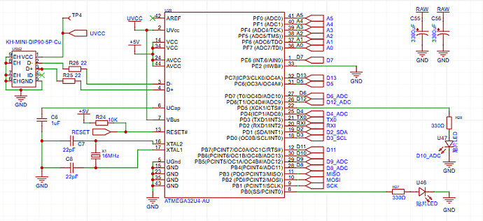

No does not come out normaly but if i ask to see hidden ports it shows it but it's not accessible, i shall send you some screen shot of what it says. it's in italian but i do think you can understand what is saying any way. I shall all add some schematics how it's connected on my board and with what i programmed the boot.

I have five electtronics which are built in the same way and two of them after programming boot if connected to the pc they are not reconised from windows. the other three it can't be loaded boot inside it they switch on but there is no way of burning boot. Now i wonder if the problem is regarding the MKII programmer. I think i choose the worst microcontroller at the moment on the market.
I never designed a board around a AVR processor but I doubt that.
Did you check all the solderings? Did you check all the components on the boards that they have the correct values?
I shall do so next weeks, It's my first time also. I tried it before using an arduino board as isp and it worked well but i used ATmega328 but with this specific ATmega32U4 i never used it. I would love to use it if it works because there is a direct connection to usb. For now thank you.
