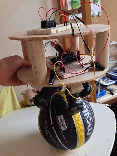

Hello,
I am currently working on a project to build a Ball balancing robot. I am using 4 onmi wheels connected to servos as shown in the picture.
My idea is to align the four servos so that i can use the roll and pitch data from my fusion sensors to drive each pair of servos. However, I ran into some issues when I was tuning with the PID algorithm. The servo was too slow, it is only 60RPM. Technically, the robot can never experience an "overshooting" from the servo motors.
Thus, I am now looking at brushless motors that has high rpm, but I am unsure of the torque. I am afraid that the robot might be too heavy for the brushless motors. How do I choose a suitable brushless motor? I checked hobbyking website and I found Inrunner and Outrunner motor. This Inrunner looks good to me Radio Control Planes, Drones, Cars, FPV, Quadcopters and more - Hobbyking
but is it suitable for my project?
Please advice, thank you:)
Calculate the torque and speed you need delivered, and then choose a motor + gearbox combination that is capable of delivering it.

The max RPM isn't especially useful since you will only achieve that when the motor is unloaded i.e. not doing anything useful.
You need to know the torque and speed characteristics that you want delivered i.e. how much torque you want available and the speed range over which you want it available. Since the available torque provided by a motor drops off with speed, the worst case is usually high speed and this will determine the power requirements of your motor.
You might find a motor which can provide the required speed and torque combination directly, but more usually you'd want to take a motor with higher speed and lower torque and gear it down (to reduce the speed and increase the torque).
A good way to approach this is to calculate the power requirements (maximum torque times maximum speed) and pick a motor which can provide that much power with a suitable margin. Then decide what gearing is needed to produce the speed and torque combination you need. If you have a choice of several motors all with suitable power then you can start considering which ones would be easiest to package - if you have one which could be used directly and another which would need gearing down, the one that can be used directly might be more convenient.
