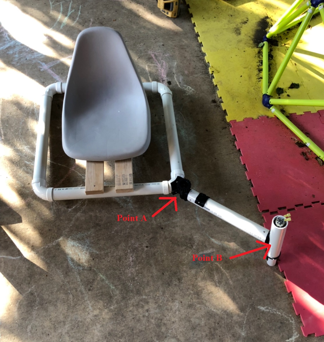

For an upcoming family reunion I wanted to build a quadruped robot. similar to the Kame robot on thingiverse...With one minor difference. I wanted to make it big enough for me to ride it, and controlled with a simple 4 direction joystick.
Attached is a picture of what I have built so far. Yes, it is made mostly from PVC pipe.
My background is mechanical engineering and materials science, so building this was in my area. However, our reunion is coming up at the end of June. I'm an amateur programmer at best.
The problem is, I don't think I can finish programming this in the next 6 weeks. I am keeping it simple, I just want it to take one step at a time, called a creep gait. All the motors will be going at the same speed. The sequence will be controlled by the limit switches. I have relays for the high current.

I see a seat, a frame and a motor.
Can you use pencil and paper to draw out how you see the rest of the machine working?
I do not want to be a Debby Downer, so I will instead talk about some of the challenges you will have.
I am not sure that drill motors are going to give you enough power to keep you off the ground.
How much do you weigh?
How much will all of the construction, motors, batteries weigh?
Without a detailed layout of your legs, you cannot begin to guess what power requirements your motors will need to fulfill.
I am not sure that your construction material will be strong enough. Again, without a detailed leg arrangement, you are not ready to guess.
Relays and limit switches to control the motors? I cannot see how that will allow you gait control.
How are you converting the drill motor's rotation to usable leg movement?

The relays cost less than half bridges and heavy duty servos. I'm using a worm drive. It will stay in place. Structurally it is fine and will support my weight. The motors are from cordless drills. They will provide the necessary torque. With the worm drive, they have a 20:1 ratio.

Help us out with the mechanical setup.
It looks like you have a hinged point at the base of the leg. I labeled that point Point A in the attached photo for clarification. Does this point allow the leg to pivot on plane with the rest of the frame, but not pivot up and down providing any lift? Please confirm or correct. I cannot see a motor for this. How will it be connected to the motor?
It looks like you are using one motor to extend/retract a telescoping foot. I labeled that point Point B in the attached photo for clarification. Does this only extend and retract to provide lift?
How strong is the connection at Point A? It will need to be quite strong.
What is the distance from the center of the seat to point B?
What is the distance from Point A to Point B?
Yes, point A is hinged with a worm screw attached. I assembled that last night. I will upload the image tonight. Point B is driven by a lead screw. since only one leg moves up and down at a time, without any real weight on it, it should be fine. I have tested point B and it supports my weight. Point A also supports my weight.
