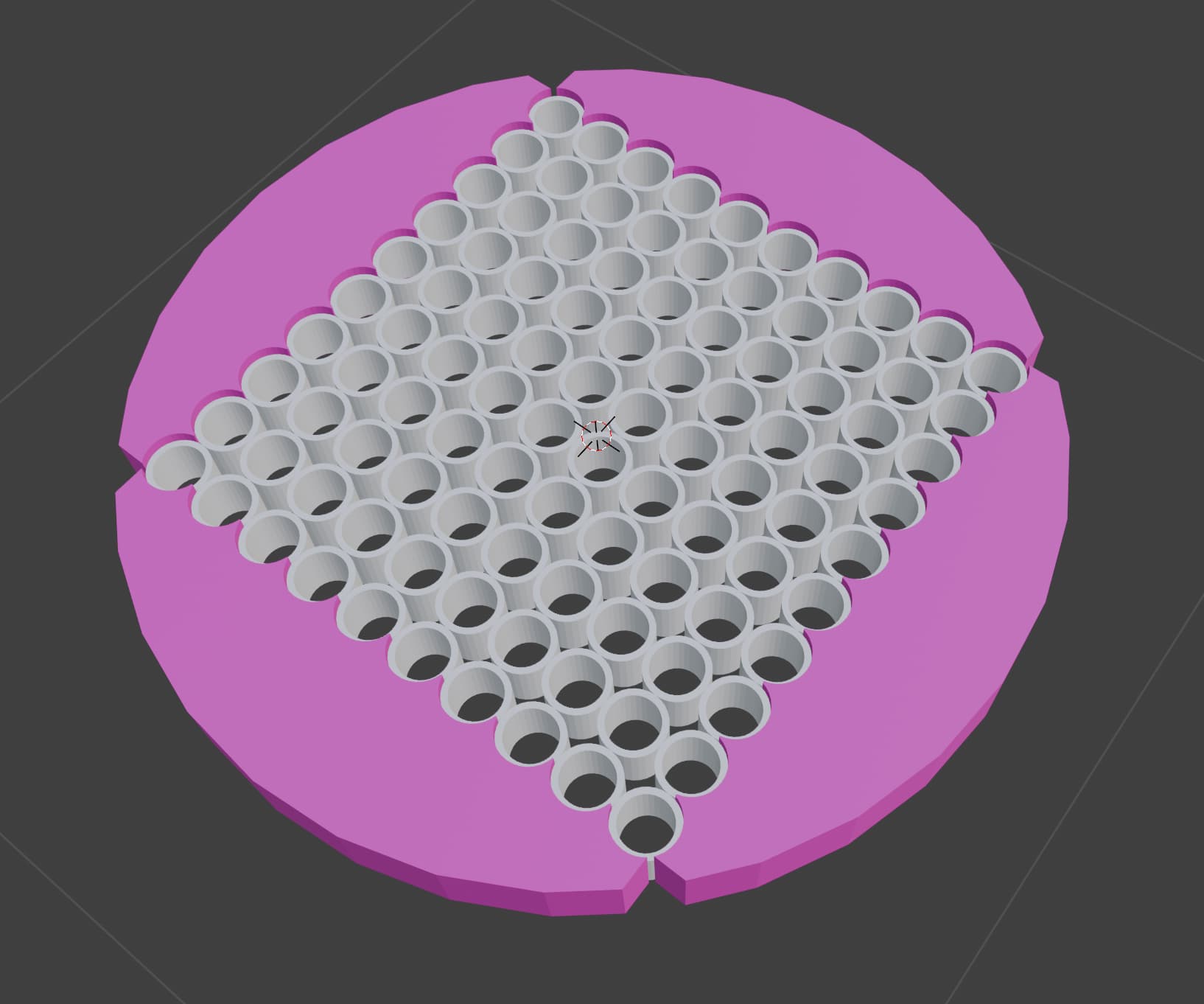

Here is a picture of a version with tubes instead of cubes. I guess, from the "challenge" described here, cubes or tubes should not make a big difference. But I hope this picture helps understanding what I want to achieve :slight_smile:
(The reason I have tubes here, is that for my prototype, tubes will be the cheapest test material)

Ok, and what goes into the tube? And do you have a prototype to work with. So far you are designing the end result before you get the mechanical part worked out.
I guess we need more info about your project: what you are trying to accomplish here and where the requirement came from.

The Tube will stay empty. The Whole construction is used to lift leight weight objects with a shape represented by the pipes that move. For example: If a ring would be lifted by the pipes or cubes, the pipes or cubes underneath that ring would go up 20 mm.
I do not have a prototype yet, I started of with visualizing the project in Blender.
Its less an issue of feasibility. I am just looking for the cheapest way to achieve it.
