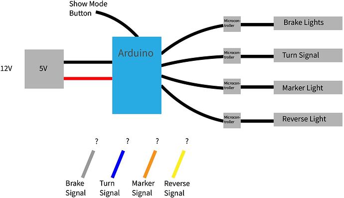

Hello everyone, I would like to start off by saying that I am a beginner, and don't know much about electronics. I am attempting to build custom tail lights for my car.
This is what I would like to achieve with my lights:
Use RGB LEDs (so the color of the leds could be switched)
All regular functions of a tail light
Sequential turn signal (flow pattern when activated)
Have a button activated "show mode" (the reason I want to use RGBs as opposed to single color diodes)
For the show mode, I would like to have it take over all the LEDs in the tail light, and perform some cool animations, and change all different colors and whatnot.
I have attatched a basic drawing of the very basic scheme that I think might work to accomplish what I would like to do. (I'll add again, not very knowledgeable in electronics) I am not quite sure how I would get the power signal from the car's signal wires to activate the lights and the code that they were assigned.
Any help would really be appreciated. Thanks!

In your image you have specified 4 microcontrollers, whcih is wrong. Arduino itself is the microcontroller board.
Anyways, first you need to get your hands on your Arduino board. You should buy Arduino Nano or ProMini as they are quite small in size and then test different examples like Serial Monitor digital read write etc.
Then interface your RGB light with Arduino and thorughout this project, you will face problems, share them here and get help.
