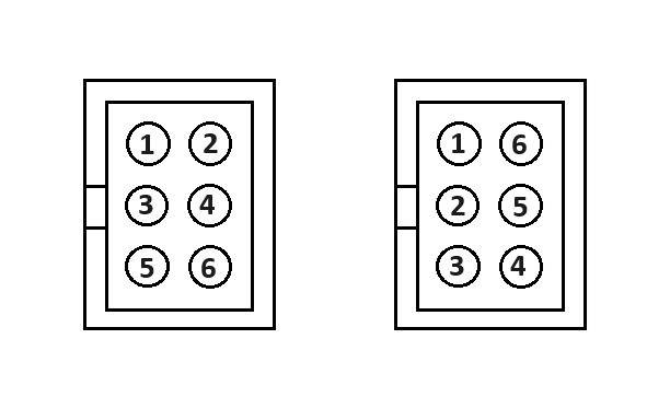

The numbering systems in use on your ISP header could cause some confusion. If what is
actually on the board does not match the conventional layout then ensure you connect the programmer appropriately.
Thanks! When I connect isp header to the programmer I refer to the pcb file (which is different from my schematic and I don't know why). But even if I connect them one to one it still do not work (I used jump wires for connection).
The normal layout of the ISP header is designed so that, if you accidentally reverse the connector, no damage is done. Hopefully, you discovered the error in time to avoid say a complete polarity reversal which may have caused permanent damage to the MCU chip.
The unexpected layout on the PCB is probably due to the internal pad numbering on that 3x2 pin header component you selected for the ISP header which may differ from that on the symbol used in the schematic. There is, incidentally, yet another numbering system where the pin pairs 1 and 2 are directly opposite each other as are the pairs 3 and 4 and the pairs 5 and 6.

There seems to be two different numbering systems for the connector used for the ICSP connector:
Pin Numbers
I think your problem is that you are somehow mixing the two systems.
It could be that the part that you used out of the library wasn't numbered in the way you thought it was and you allocated the connections using the other numbering system.
the one on the left is correct, the one on the right is wrong.
....and that is the one that appears on the schematic in post #3.
Important only is that the numbering system on the schematic symbol matches that of chosen PCB component in order to get the board correct. There is a variety of possible schematic symbols in Kicad :
Definitly. That's why it pays reading the docs. In this case Figure 1-2.:
