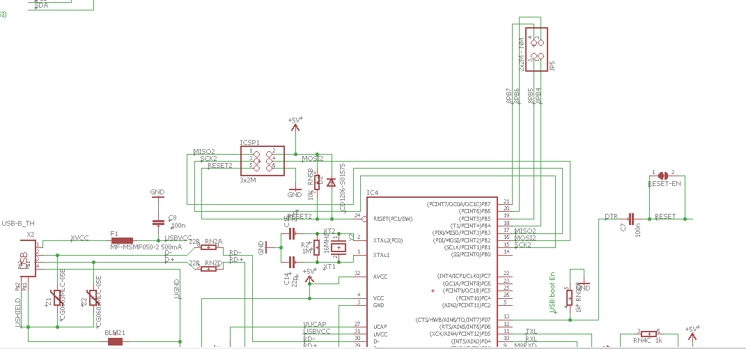

If you can program the fuses you usually can program the flash memory too. Please explain exactly what you you do and how you wired the board to the USBasp. Also please provide a schematic of that board and a link to the product if it's commercially available.

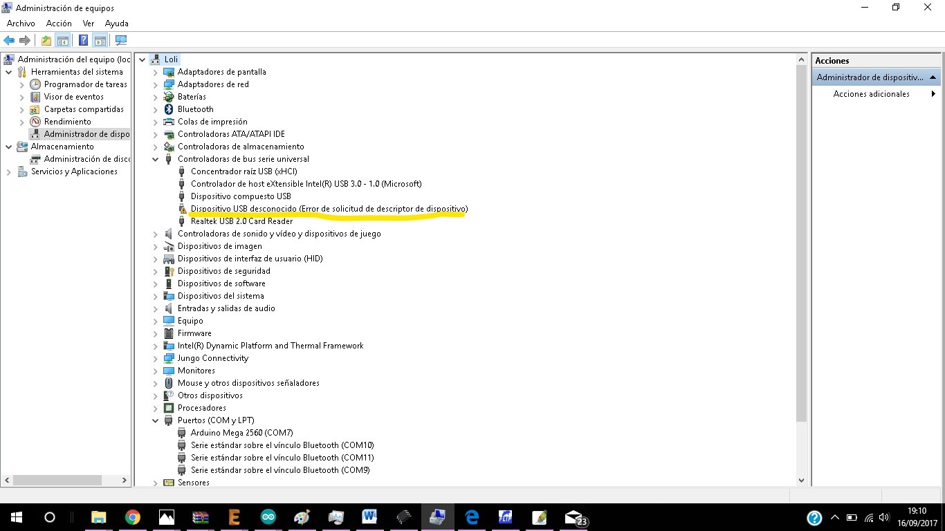

I think all is Ok, but I find the same reply in the "Device Manager": Unknown Device USB.
The wire is the same in Mega2560 R3 board as in the next image. The only difference is that I have another resistor (10K) wired to PD7 (pin 13 in Chip Mega16u2)
What vendor/device ID do you see then? (I hope Windows can display that)
You are sure that you don't see the USBasp as the unknown device, aren't you?
When I load the file "Arduino-COMBINED-dfu-usbserial-atmega16u2-Mega2560-Rev3.hex" trought USBasp to my board I see nothing in the "Device manager", I don't see ID, don't USB connection.
When I finish to load throught USBasp I disconnect this cable and connect only the USB cable to connect my board to the computer to check that all is Ok.
and I see only the reply in the atached image "No id, no vendor".
Post the schematics of that ATmega16U2 board.
