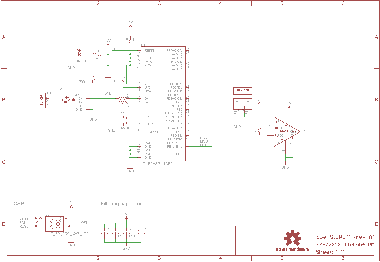

I grabbed a USBtinyISP from Adafruit last week, then used it today to flash the Leonardo bootloader onto my custom ATMega32u4 PCB project board (schematic here: http://jason-webb.info/wp-content/uploads/2013/04/openSip+Puff-schematic.png).

Can you verify you are getting 3.3V on pin-6 on the 32U4? That should verify the internal 3.3V USB regulator is enabled for the proper USB data line levels.
Also you should have a 1uF capacitor on pin-6 to GND.

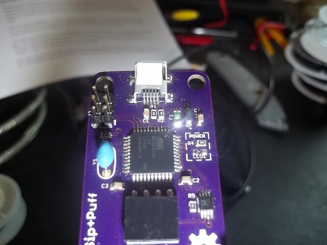

I've attached a couple of photos of the soldering job, if that helps.
Oh, and there is a 0.1uF capacitor going to ground from pin 6 already. All of the other ATMega32u4 board schematics I could find had a 0.1uF, not a 1uF. Attached the schematic.
Edit: Oh no!! I just checked all the schematics again, and found that only Adafruit's 32u4 breakout has a 0.1uF to ground, all the others have 1uF! Holy smokes that's something.
For my own education, can someone help me understand what this UCAP capacitor does, and why the value may be accounting for this behavior?

UVCC is indeed tied to VBUS and VCC, as seen in the schematic posted just above.

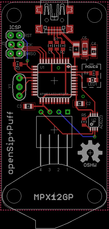

I've attached a picture of the PCB design for reference.

There is a F1 fuse right at the USB connector. Did you measure before and after the fuse?
Yes, check the comment directly above yours. Measured the same voltage before and after fuse.
Sorry, I missed that. With those results it would point to something with the USB connector. There may be a bad connection with either the GND pin-1 or VBUS pin-5 internally to the connector. Do you have a USB breakout cable? It may be that the cable is not contacting correctly in the socket.
Do you have another USB connector? You may need to consider replacing it.
Those SMD connectors are a pain to solder! Definitely switching it over to the PTH variety for the next revision to make it easier on myself.
I have a pile of extra USB cables, I'll try to hack one apart and solder the wires directly to the board.
Have any tips for desoldering the thing from the board? I always seem to take the pads off the PCB when I try to get connectors like this off.
Yes, I agree, smd stuff is not easy. You definitely need to watch for over heating the board or risk lifting the pads. Which may be causing your problems.
I've gotten pretty good at passives down to 0805, SOT-3, TSSOP and TQFP, but with parts that have large pads for mechanical strength (DC power jacks, JST, USB) I can generally get them on, but not off. However I set my soldering station temperature I seem to either have it too hot or too cold for desoldering those huge pads. Oh well, it's a prototype...just an expensive one :S
I removed the the USB connector and soldered the wires from a hacked USB cable onto the pads. Now when I plug in the USB cable my computer recognizes it just fine. I get a USB composite device and a USB input device in my Device Manager.
