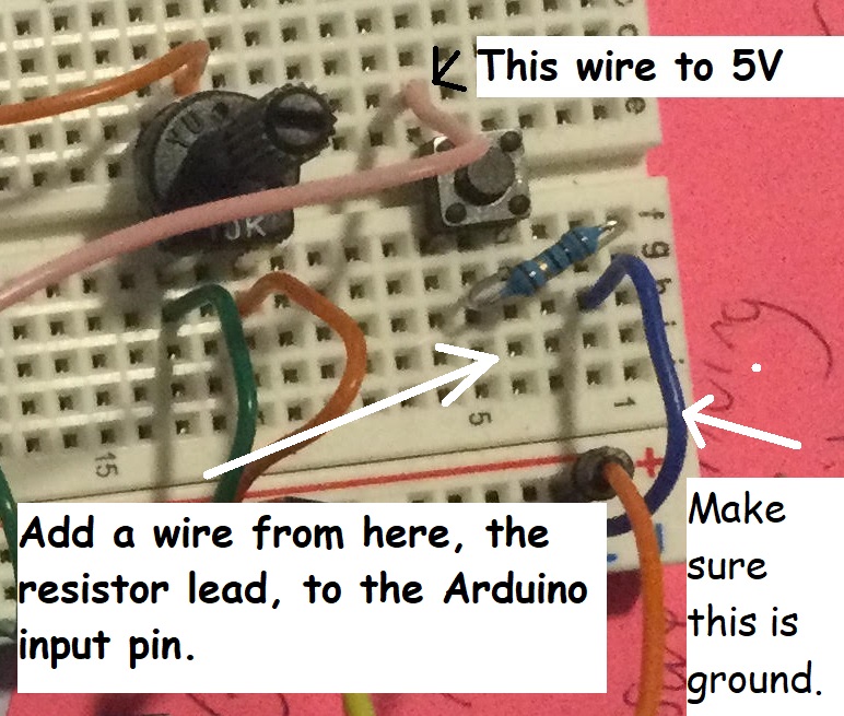

I have a button connected to the Arduino MEGA2560. It is very frustrating as even though I am sure I wired it correctly with a resistor between the button and ground, the button is being read as HIGH even when it is not pressed. I've tried changing the wiring to no avail. I would like to know what is wrong with my circuit/code so that the button actually works and "System reset" isn't output on the LCD screen no matter whether I press the button or not.
picture of wiring attached

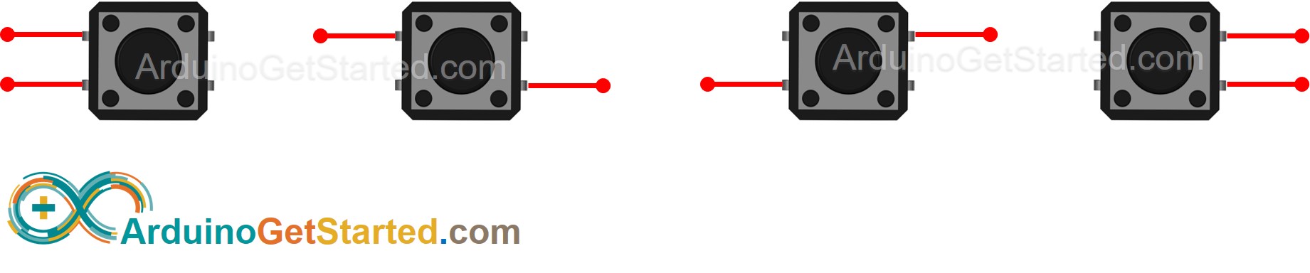

Make sure that your wiring is one of four ways (actually two because of symmetric)
#2 and #3 work no matter how the button gets rotated. #1 and #4 don't work correctly if the button has the wrong rotation.
There are very similar 2 pin buttons that
  1. Don't try to jump out of the breadboard
  2. Cannot be wired incorrectly
    Example: https://www.ebay.com/itm/100pcs-2pins-Tactile-Push-Button-Switch-Tact-Switch-6X6X5mm-Momentary-Pop_UK-dr/274465407735?pageci=501ac1ca-6adf-4771-af7e-3dd572b51661

Looking at your project picture, you do not appear to have the button wired correctly.
Try this with your original code setup.
Tom.. :slight_smile:

Thank you for your replies everyone! I have tried all your suggestions and unfortunately it is still not working. I have soldered longer legs to the button so it should definitely be making a connection now. It just prints "system reset" no matter how I wire the button or how long I press it...
Do you have a DMM to measure your circuit voltages?
If you connect the input pin8 to gnd and then to 5V you does your display show?
(Disconnect it from the button circuit first.)
Tom... :slight_smile:
Hello,
I don't have a DMM but I have a tabletop oscilloscope. After connecting one probe to the back side and one to the front of the button they both read 0V when the circuit is powered. When I changed the wires as you suggested the display still shows "System reset".
However, after pressing the button, the probe measuring the same side that is connected to +5V jumps to 20mV whilst the probe measuring ground stays at 0V.

Thank you for your suggestion, I've changed the code and uploaded it but no luck sadly!
Edit: actually, the LCD screen now prints 'do not touch your phone' instead of "system reset" so this is progress at least! The button doesn't change the message when pressed but it does make the message disappear
Connect your scope gnd probe to gnd of your project and leave it there, all your measurements should basically be done with respect to gnd.
Connect the other scope probe to the digital input that the button is connected to.
See what trace you get when the button is pressed and not pressed.
Hello,
I have connected it as you have suggested and after I press the button nothing changes, the trace stays at 0V.
Can you post some more pictures of your project from different angles so we can see where all your wires go?
