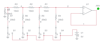

You can use a resistor network to decide which button was pushed. If you had SPDT switches, an R-2R network would be the way to go.
Something like this, just instead of the opamp buffer connect the Arduino.
Alternatively, for SPST, you can also use this (the voltages will be a bit different) or you can make the resistor network however you want and just use that pic for inspiration.
I have done this before and I think it should allow you to use more than 10 buttons per one input.
