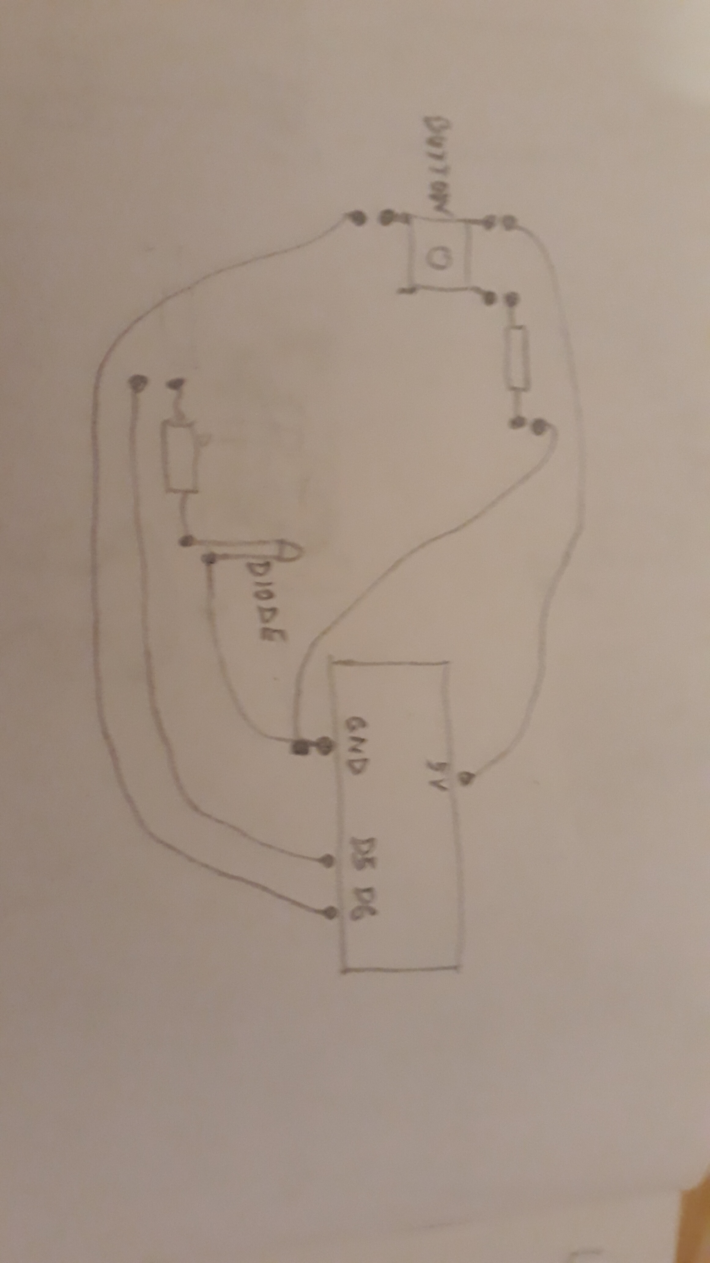

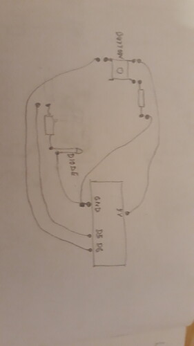

I was trying to create a code that would cause a LED diode to light up every time a push button is pressed. But when I uploaded the code to Arduino Nano the diode was lightening all the time. I don't know, whether the problem is in the code or in the wiring.

I'll bear that in mind. I tried your code but the diode is on all the time as it was with mine.
Wiring the tactile momentary switch.
You had better to use INPUT_PULLUP.
See how to control LED by button
Thank you all for the tips, I tried it, but it did't function. I guess there is a problem with the button, because when I checked the serial monitor there were zeros all the time, no matter whether the button was being pressed or not.

Then just try a jumper from GND to the input.
Did you see the important part about wiring to diagonal terminals of the switch? If wired straight across, there is a 50% chance that the wiring is a dead short.
Thank you, now it functions
