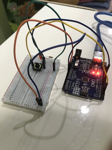

Hello everyone, I am learning inputs and buttons with Arduino at the moment and I'm struggling to get my code working as intended which is why I am making this post.

This code makes it so that whenever I press the button, the LED lights up. I have also made it so that whenever I pressed/unpressed the button, the serial prints out whether the LED is on or not. The log I get, however, are messages of"LED Off" getting continuously spammed to the monitor. I suspect that the issue is in the board I set up itself, so here is the board I set up:
What I have tried so far:

Here's the OP's picture:
It all looks OK to me.
I had some of those pushbuttons in my original Arduino starter kit and I found them really awkward. They would pop into the breadboard in a way that felt about right, but often they didn't make electrical contact with anything.
To test for this, remove the switch and use the tip of the jumper wire to connect/disconnect instead.
GypsumFantastic:
I'm really new to this, but after I have removed my switch where do I place my jumper wire exactly? Apology if it was already obvious. :slight_smile:
From your photo it looks like you've got a yellow wire and a dark-blue wire connected to either side of the switch.
Then you removed the switch. Unplug the yellow wire from the breadboard and plug it in the same row as the dark blue wire, so the yellow and blue wires are directly connected.
Does the LED come on?
What do you see on the serial monitor?

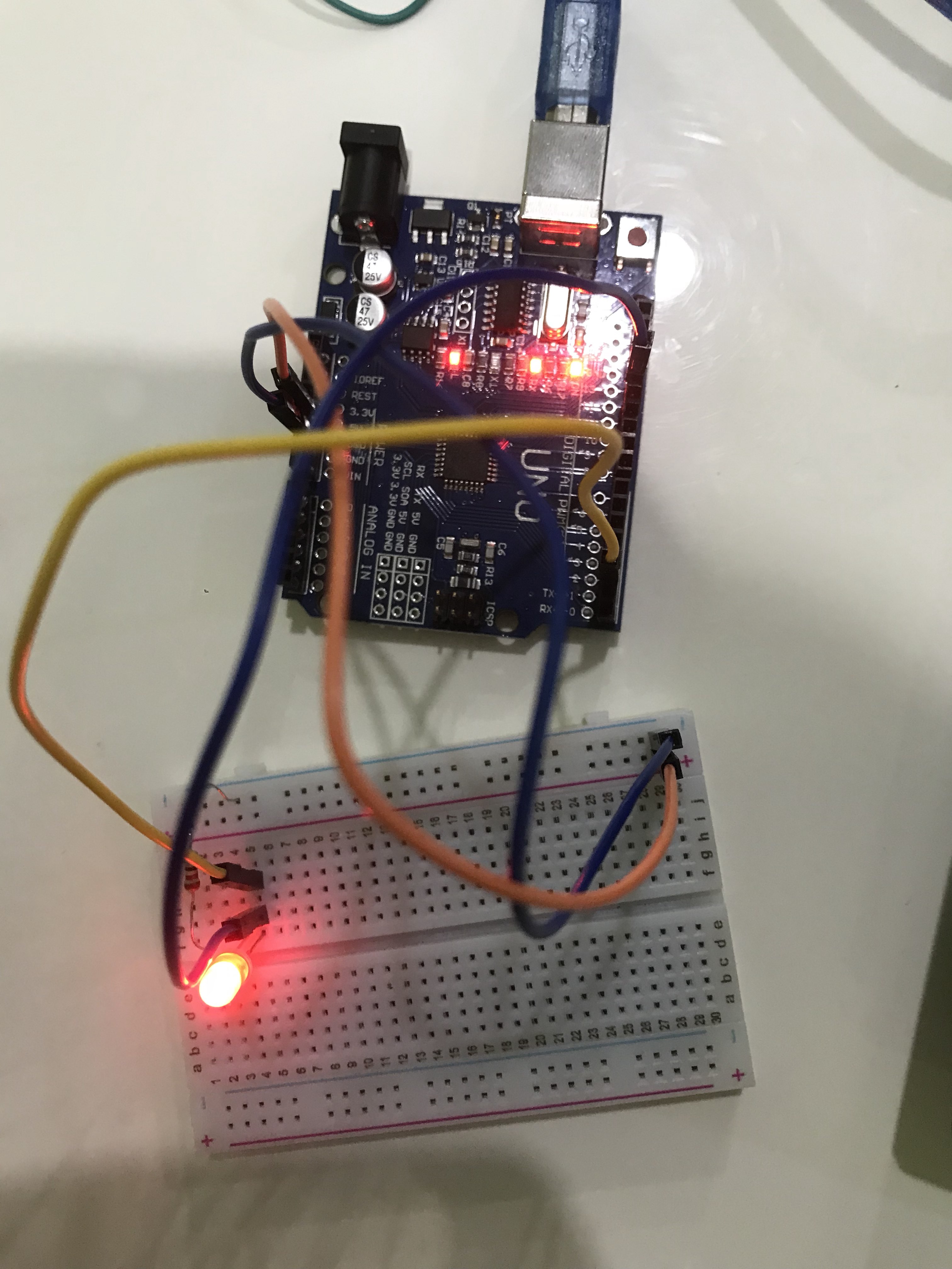

Hey Gypsum, here is the result along with what I did.
And yes, the LED did turn on.
Great news.
And now the serial monitor is spamming you with "LED On", yeah?
Looks like the crappy little switch is the problem.
This is a little late, but the log spams "LED On" and "LED Off" continuously. Even with this, do you suspect that the switch is still a problem and how do I fix it? Thanks in advance!

Hey Gypsum, thanks for the short and clear explanation! And as for the button itself that you said was the problem in your previous reply, I'd like to know whether to buy new buttons or is there a fix for it? If I have to buy a new one which one should I buy? (I don't know when I bought it, it will be the right one or not)
It is not a problem with the button.
The problem is that the breadboard has such deep holes that the short pins on the button do not properly penetrate.
The button - and almost all of its ilk - is designed to be soldered into a PCB, not mounted on a breadboard. So you will simply not find buttons that will fit.
Sooner or later, you will need to learn to solder. If you do not already, you need to find a mentor who is already set up to solder things, who will teach you to solder wire off-cuts to the switch pins so that they fit properly into the breadboard.
