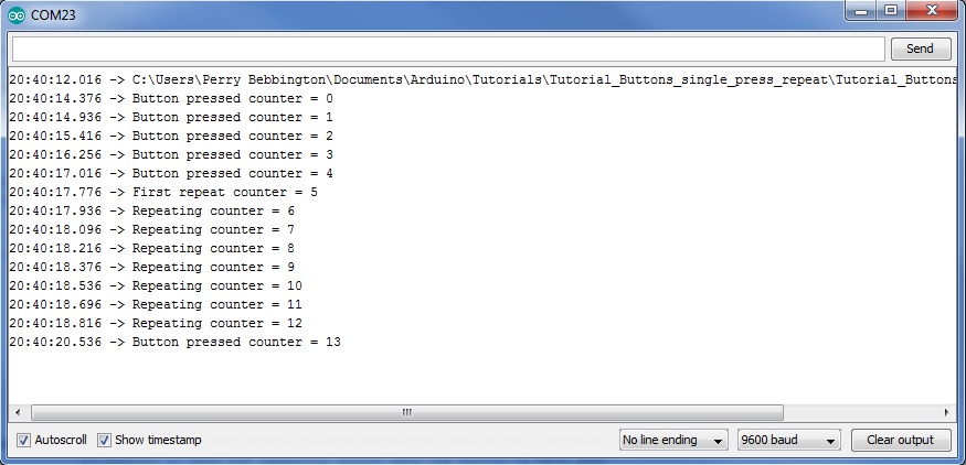

Output on press then repeat while button is held
This code sends "Button has been pressed" to the serial monitor when the button becomes pressed then repeats while the button is held. To make it obvious what is happening I have included a counter that increments if the button is held down. You can vary the time before the repeating starts and you can vary the interval between each repeat. This version includes a state machine in the Buttons function.
/* Simple debounce for a single push to make button wired between ground (0V) and buttonPin */
/* This version sends "Button has been pressed" to the serial monitor when the button becomes pressed */
/* then repeats as long as the button is held down. Includes a counter to make it clear what is happening */
/* The function Buttons in this tutorial is constructed as a state machine */

This is what you can expect on the serial monitor

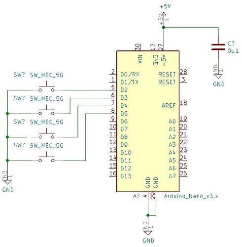

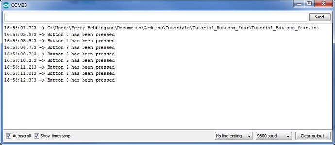

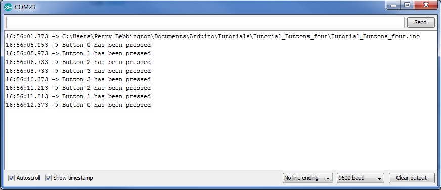

Multi button input
This version reads and debounces 4 buttons with code can easily be changed for more or fewer buttons.
Schematic for 4 buttons
Here is what it looks like with a Nano Every on breadboard
