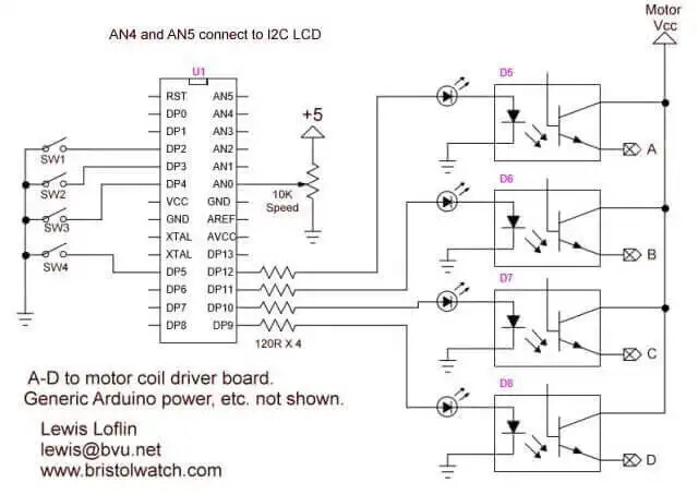

that is the code i uploaded to my uno,for some reason the buttons are not getting read,do i need to install a special library for it the read the buttons,if so what is i called so i can install it via the ide?,thanks.

so what needs to be done to fix the code?.
If you need to read buttons at the same time as you are doing other things, then you have "do several things at the same time"/multitasking problem. One way of solving it for buttons is doing the counting on the change-of-button-press-state with tricks as in:
  • So where is your schematic ?
  • So give us links to your hardware.
  • So get rid of delay(. . .) and avoid using while( . . . )
  • Describe your project.
look at the link for details,its the coil winder project,i am using an arduino uno with a homebrew mosfet driver,the info is here ok Arduino Stepper Motor Drive Coil Winder

  • Do you know your switch inputs are floating if you are using the above schematic ?
  • What are A, B, C and D connected to ?
  • You should always show us your schematic you are using.
    Also we need good images of your actual wiring.
hi larry,thats the schematic i am using,i built that winder about 3 years ago and all was fine,when i came to remake it a few days ago the winder txt link gave a 404 error,i informed mr lofflin about this via youtube and he fixed it and the code link was working againe,looks like the code may of been corrupted?,i know about zero at best about code,i am more involved in the hardware ok,cheers Paul.
  • We have no idea what controller you are using :woozy_face: .
    Your schematic should be updated to include the actual controller being used and the A,B,C, and D connections.
do the switch inputs need pullups then?,if so its strange as i made this about 2yrs ago and it worked fine,the schemstic is slightly different as the neg side of the led's go strait to gates of logic level n type fets,or at least thats how my working version was wired.
abcd go to each stepper coil.
  • Yes
  • What stepper ?
  • This is why we need to see an updated schematic, i.e. as you are currently wired.
the steppers are nima 23 hybrid motors,see datasheet,regardless that wont have anything to do with button pushes not redgistering!
