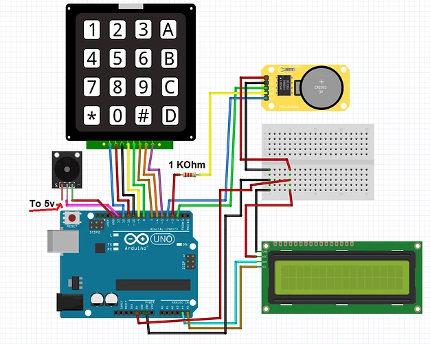

The tone() turns off with delay() command, but the default 2KHz tone of the buzzer continues to pierce my ears. How do I stop the default tone from playing in between beeps? Even noTone() doesn't stop the default buzzing frequency.
I've connected the buzzer to 5v, GND and pin d13 (UNO)
This is how the whole alarm clock is connected. I don't have a resistor between the buzzer and the power. The buzzer I'm using is TMB12A05
Do you have used an active buzzer instead of a passive buzzer.
Yes, it's an active buzzer
active buzzer generate sound by it self, no use of tone()
Use a passive buzzer.

It says it's not a true piezoelectric buzzer and I also think so as yesterday I ran a program that played the Russian anthem to check if it can play melodies and it can. So it's not a fixed frequency buzzer. So in reality it's like a tiny speaker
"This is a small 12mm round speaker that operates around the audible 2kHz range. You can use these speakers to create simple music or user interfaces.
This is not a true piezoelectric speaker but behaves similarly. Instead of a piezoelectric crystal that vibrates with an electric current, this tiny speaker uses an electromagnet to drive a thin metal sheet. That means you need to use some form of alternating current to get sound. The good news is that this speaker is tuned to respond best with a square wave (e.g. from a microcontroller)."
description of the buzzer from a website
