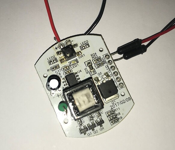

Hello all,
I am trying to create a cigar humidifier using arduino UNO, a DHT22 humidity and temperature module and an ultrasonic atomizer (with its board) that connects to the Arduino via a MOS module.
I have set up the modules and all is good except one thing. Due to the fact that I couldn't find any ultrasonic atomizer with board designed for Arduino in my country, I bought an USB desk humidifier and disassembled it. Unfortunately the humidifier has a push button for on/off on its board (as you can see in the picture).
The question is how can I bypass the button so when I set the MOS to 1 the humidifier starts directly without the extra/necessary step of pushing the button.

Does it work, when the button is pushed all the time (Even before plugging in the USBhcable)?
If so, just soldering a piece of wire across the push button pins should work
Hello Couka. No it does not. If you push it once it turn is on; push it again and it turns it off, and so on.

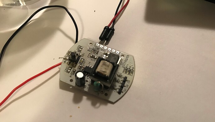

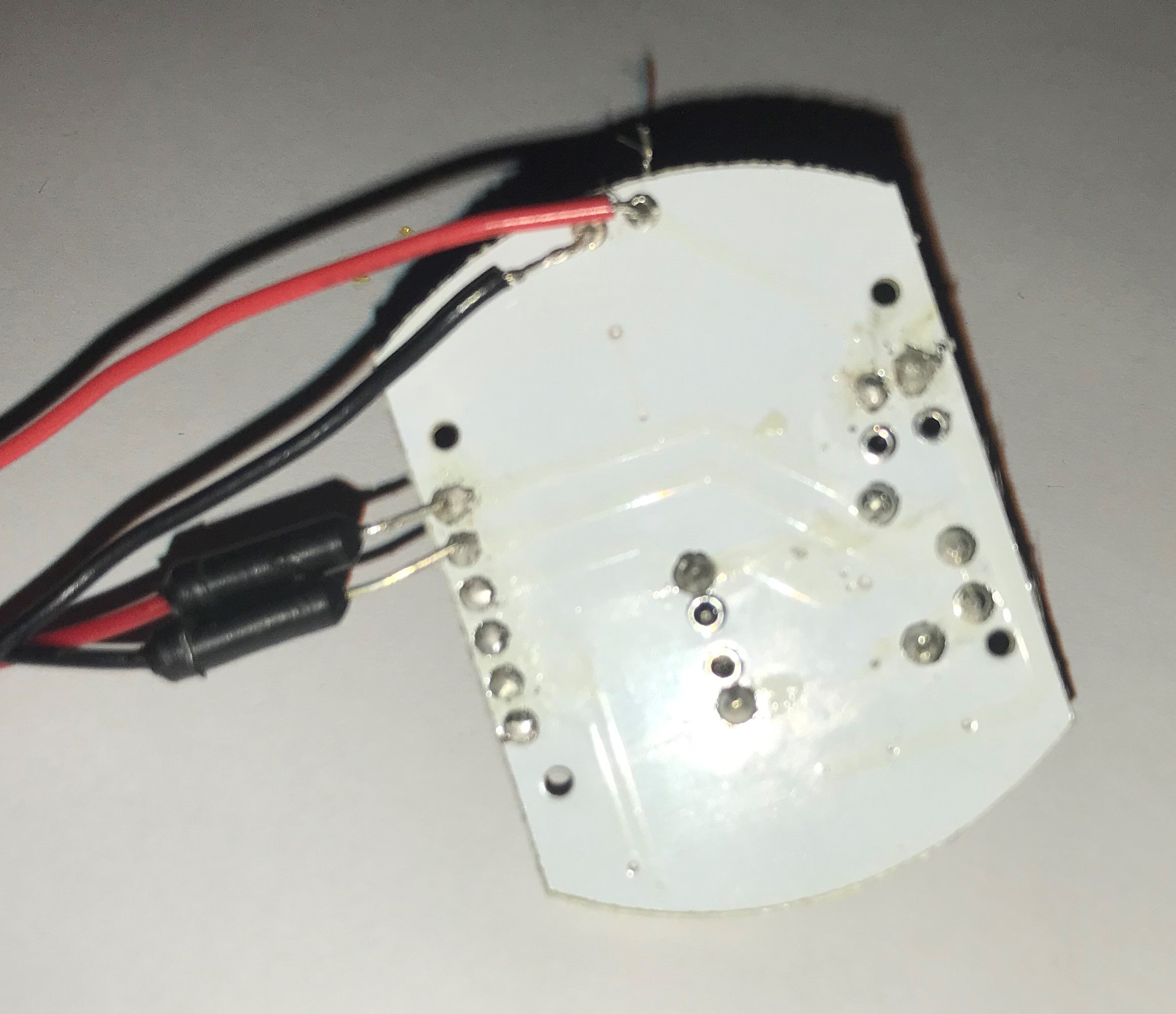

Then you need to provide more information, at least good-quality, sharp pics of both sides of the PCB of the humidifier
Attached front and back, better resolution
I'm probably not the best Person to answer your question but as the thread is going stale, here's my thoughts about how I would Approach the Problem.
First off, decide if you want to maintain the ability to push the button and turn the device on/off manually or not. If you want to maintain that ability, you Need to be able to simulate pressing the button through the Arduino. Though the Switch has four Pins, it is probably only one Switch and two Pins are shorted to each other (for example, both top Pins are shorted or both left Pins). To find out, just measure which two Pins are always shorted and your circuit should provide an Arduino controlled short between the other Pins.
If you don't care about the Manual mode and want everything solely under the control of the Arduino, I think you should just find out what voltage is on the gate when the device is on vs. off. Assuming the gate measures near 5 Volts when on, your circuit should provide control between the 5V and the gate to turn the device on.

Willpatel_Kendmirez's information is correct and accurate for this type of pushbutton.
With this type of pushbutton, if you don't have the information or are still having problems identifying the correct connection, then by choosing diagonally opposite pins you will get the correct operation.

I have measured the voltage between the pins when the water atomizer is off and this is what I have (if I number the pins according to the picture attached):
1-2 = 4.91
1-4 = 4.93
1-3 = 0
2-3 = 4.93
2-4 = 0
3-4 = 4.93
a-c = 0
Another aspect of the pushbutton that I saw is that long press does not activate the water atomizer, just a short press does the trick.
Also, when the button is pressed I get 2.26V between a-c and of course 0 if pressed again.
@JohnLincoln I tried connecting a wire between 2 and 3 and nothing happens. If I touch 2 and 3 or 1 and 4 for a fraction of a second it simulates the pushing of the button and opens the circuit.
Thank you
So the red+black wires connected next to the switch are the 5V power supply, and the other 2 wires to go the atomiser module?
If so, you should measure the voltages around the switch relative to the black/psu-ground. Otherwise you could be measuring meaningless floating voltages against each other.
I suspect that you can simply connect an Arduino pin directly to one of the switch contacts to control it. If course, the Arduino and the board must share a common ground. To simulate pressing the button, the Arduino sketch can change the pin to OUTPUT & LOW for a couple hundred milliseconds, then back to INPUT.
