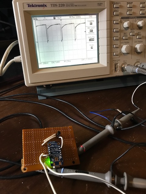

The two connections have about 6 volts DC across them, with the middle screw (#2) being the ground/negative and the right screw (#3) being the positive. Shorting the two terminals together results in about 60 mA of current flowing, so there is a resistor in series that prevents a short circuit when the terminals are shorted together. Both the emitter and the receiver are powered by the voltage from these screws, and the output of the receiver is sent back to the head unit over these same power leads by shunting the leads together to create a pulse train. The oscilloscope work reveals the timing that signals the garage door opener that the beam is not obstructed. The absence of these pulses causes the opener to be unwilling to close the door, and it reverses to the open position automatically if the pulse train is lost while the door is closing.

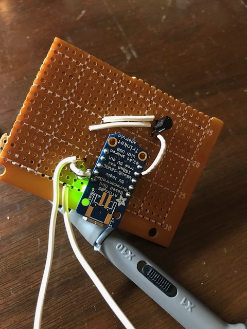

I used an ATTiny85, an N-type mosfet, a 7805 regulator, and a few caps & resistors to create a compact standalone unit that emulates the "all clear" signal and allows the opener to operate normally with broken/disconnected/missing sensors.

circuit:
- 5vdc power provided to ATTiny via 7805 regulator across the ~6.4v supply provided by the opener's safety sensor terminals.
- the usual capacitors connected to the 7805 are plenty to provide uninterrupted power to the ATTiny85 while the supply voltage is being shunted.
- gate of mosfet or transistor connected to pin 2 of ATTiny
- source of mosfet connected to ground of power supply and terminal 2 of Liftmaster/Craftsman opener
- drain of mosfet connected to terminal 3 of Liftmaster/Craftsman opener
int pin = 2; // pin to which a transistor or mosfet gate is attached
pinMode(pin, OUTPUT);
// 6.5ms/.5ms code
digitalWrite(pin, HIGH); // shunt, then wait 0.5 milliseconds
delayMicroseconds(500);
digitalWrite(pin, LOW); // open, then wait 6.5 milliseconds
delay(6);
It works like a champ! It worked on the first try while being powered by a battery, so I added the 7805 voltage regulator and allowed the microcontroller to be powered by the same voltage that it is shunting, and that also worked just fine on the first try.
