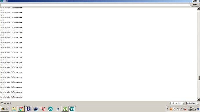

Folks,
I need to read bytes from a measurement device, I have already visited several topics and I was able to implement some classes and read data through the serial port using the Javacomm and RXTXcomm API, but I am having difficulty interpreting the bits, I believe it is due to the way of reading .
The device emits a block of 8 bytes every second, the data is binary, reading as below I get to numbers equal or less than 255, what should I do to have readable data?

your code also reads data when none is available
What are you expecting to read ?
Numbers ?
Text ?
Both ?
Image from Original Post so we don't have to download it. See this Simple Image Guide
...R
What is the device sending these bytes?
Also, which device is reading these bytes?
 Serial1.begin(110); //Comunica com o medidor
110 bps is too slow for HardwareSerial on a typical AVR-based Arduino running at 16 MHz (or even at 8 MHz).
SoftwareSerial should be able to do it.
