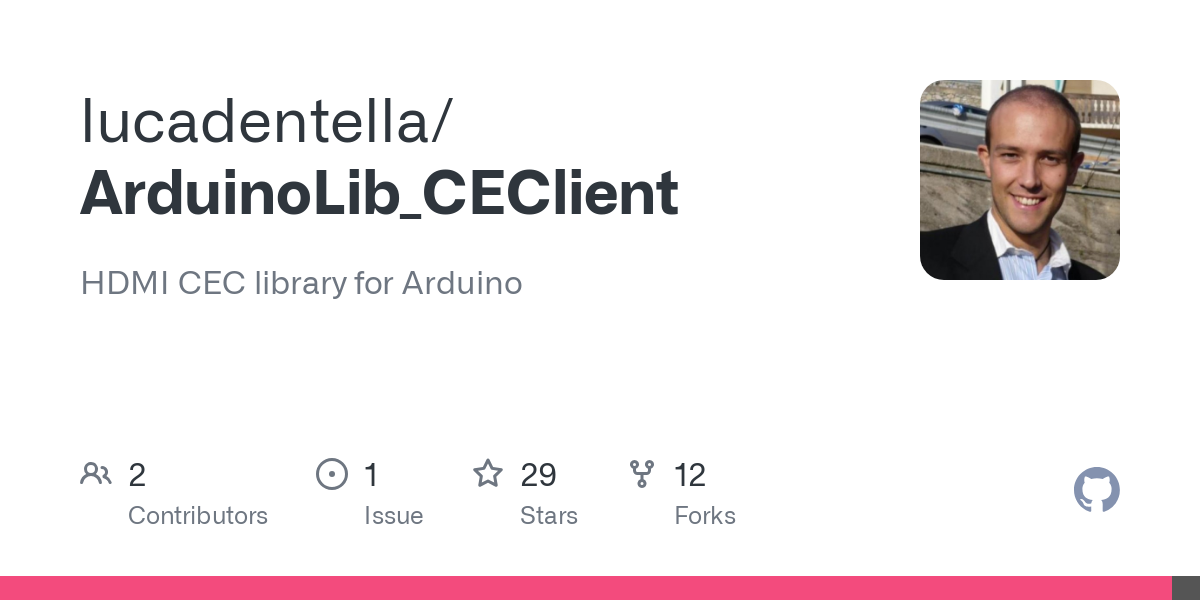

It is not clear from your question, where did this file CEClient.h come from and where is the implementation of all these functions, the headers of which we see in this file
It’s this library
My issue is not with the library as such, just how to properly declare and reference CEClient across other modules within my own project.
