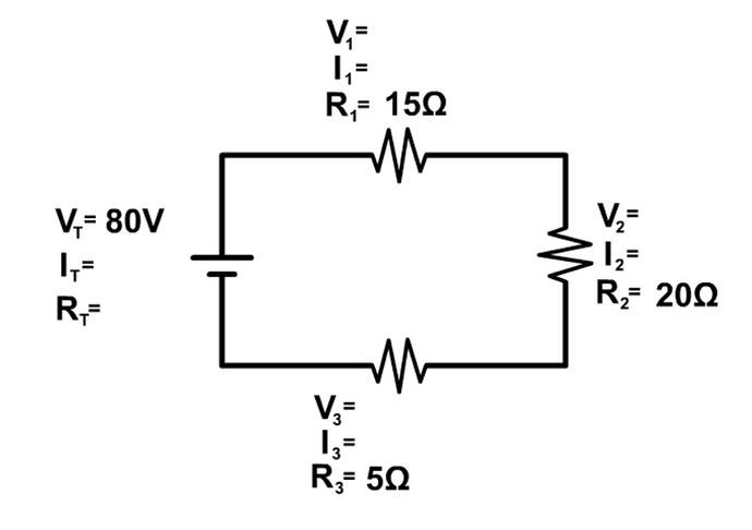

Ok so I’m new to electronics so plz have mercy. I’m going through the basics and am able to find the voltage, current, and resistance at each resistor point in the circuit using ohms law. I started with series circuits and moved unto parallel and am getting decent at combinational circuits composed of both series and parallel circuits.
However the problem with the examples I’ve been using is they only use resistors when solving for the voltage, current, and resistance. I want to be able to calculate the voltage, current, and resistance for every point in the circuit not just at the points with resistors. What about circuits with transistors and LED’s and other electrical components? The tutorials I’ve been following don’t seem to address this. It just stops after combinational circuits and only uses resistors when presenting series and parallel circuits.
For example, how would one solve for the voltage, current, and resistance at every component point in this circuit?
If you could solve this example and explain it that would really help me learn.

The way that the tutorials showed how to solve combinational circuits was to break each section down into parts and combine them to make a bunch of blocks of one giant series circuit. How would you do this for this circuit?
Heres what I'm talking about

Also I have no way to calculate the resistance for the led and the mosfet. Do you treat them as a resistor? I'm confused. Hope this adds a little clarity
Lets start here. What is the total amperage of this circuit using Ohms law to solve?

the total amps would be 2 amps
Total current.
So you know the total amperage draw. Do you see any ratio relationships between the resistances?
I thought the total current is 2 amps am i wrong?

Transistors and diodes are non linear devices that don’t have voltage to current relationships that can be calculated using ohms law .
A diode for example will have a forward voltage drop of around .6 volts which is pretty well independent of the current it passes .
You need to study diodes , then move onto transistors .
Capacitor and inductors also have “ strange “ characteristics . Batteries too dont obey ohms law either .
Ohms law , how a transistor works , Kirchhoffs law etc ( google )
You would need datasheets on your "ZVN" T1 and LED1 to tell you their voltages and resistances.
Or with "SW" open as shown, and assuming T1 is ideal, replace T1 with an infinite resistance and solve as normal.
