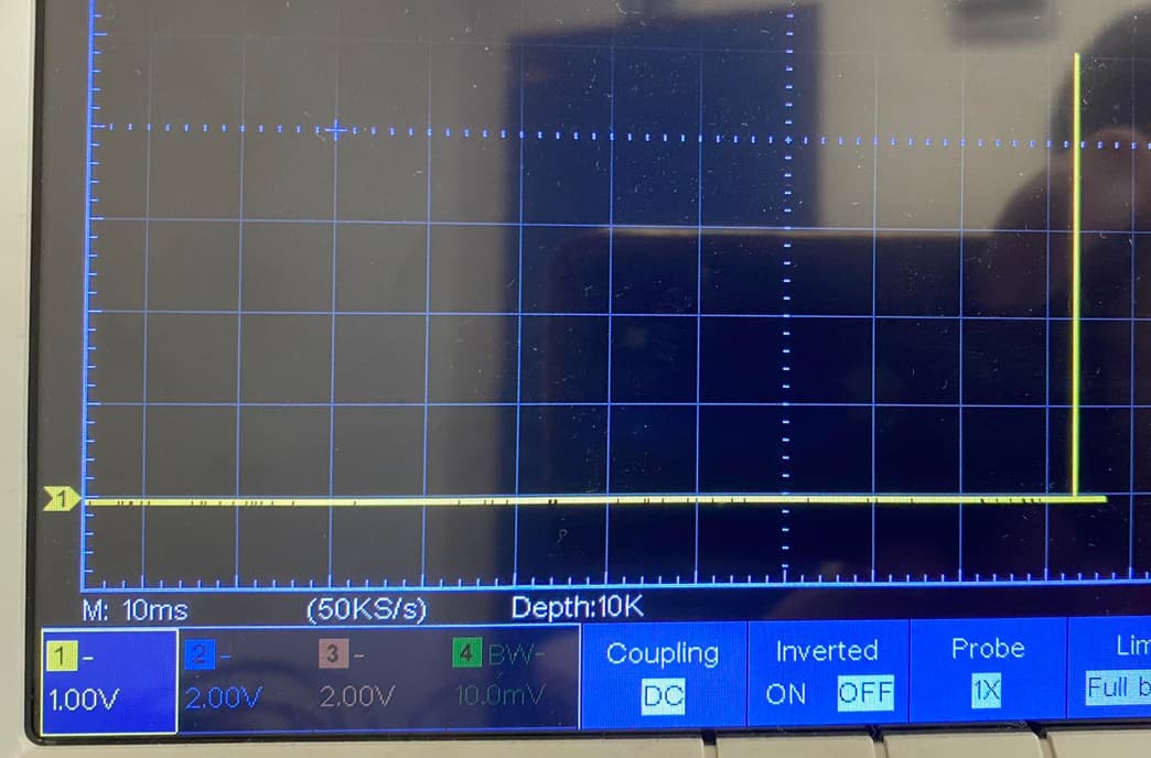

I am sending a photo from an oscilloscope of what R looks like after the conversion.
The original R looked like this.
Screenshot_8
Could the shape of the R cause a problem?

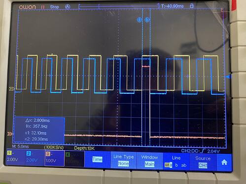

Can you post images of what you are getting from A and B outputs.
It looks like the conversion is into "quadrature" encoder signal.
Where A and B are 90deg out of phase, the direction of rotation is determined by the direction of the phase difference.
The R output is a syncing pulse, usually once in each encoder revolution.
Looking at the diagram above, R4 (10k) connection does not make sense to me. You might be better off omitting it altogether just like for A and B and using INPUT_PULLUP on D4, without the resistor (unless that's what you had already tried).

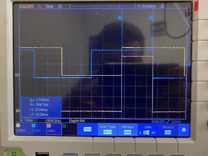

The duration of the R pulse seems very short, from what I can see from the oscilloscope photo. It shows you are at 10 ms. Are you able to make the time base faster and actually measure the duration of the R pulse?
I am sending a picture from oscilloscope. A is yellow, B is blue and R is orange.
Thank you for your reply. I have done a better job of displaying the R. Is it enough to just measure it like this with the cursors?
Thanks for posting the scope images. Very helpful. The measurement with cursors is what is needed and tells us that the R pulse is of a reasonable duration (2.78 ms).

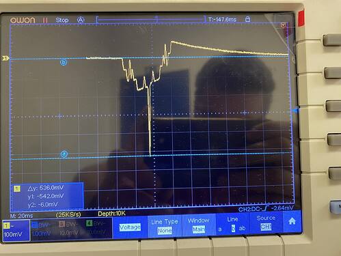

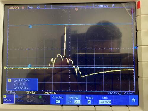

I started with the easy way. I am sending pictures of what the R+ and R- output looks like directly from the encoder. So should I try to connect it to the Analog input and try to read something via analogRead() ?
I don't think that will work. The signal is quite ragged and you won't know what value to choose for a +ve result.
And thanks for measuring the voltage: this is a surprising result. It is only ~500 mV. I was expecting it to be ~5V, assuming you are powering the encoder with 5V. This small change likely won't be enough to trigger an interrupt, or be readable as a digital HIGH value either.

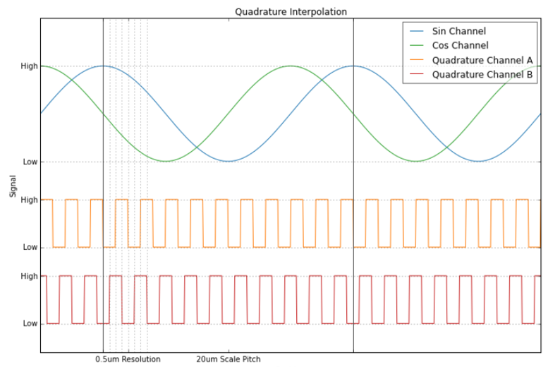

You posted a picture in post #16 of the expected signal wave forms. Where is that picture from?
Looking at it, it shows that there is an alternate signal shape for R, shown with a dotted line. That signal appears to have clear and sharp edges, and may be better suited to connecting to the Arduino, etc. Unfortunately, that picture only shows a 0 reference for R, but does not show what the actual voltages are.

Thats from official datasheet. https://www.heidenhain.com/fileadmin/pdf/en/01_Products/Prospekte/PR_Rotary_Encoders_ID349529_en.pdf

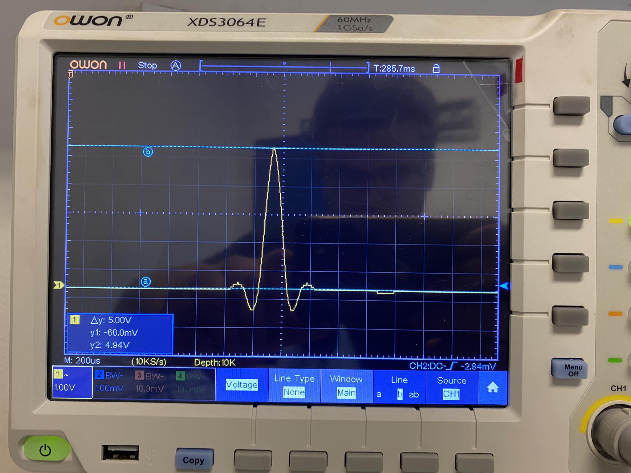

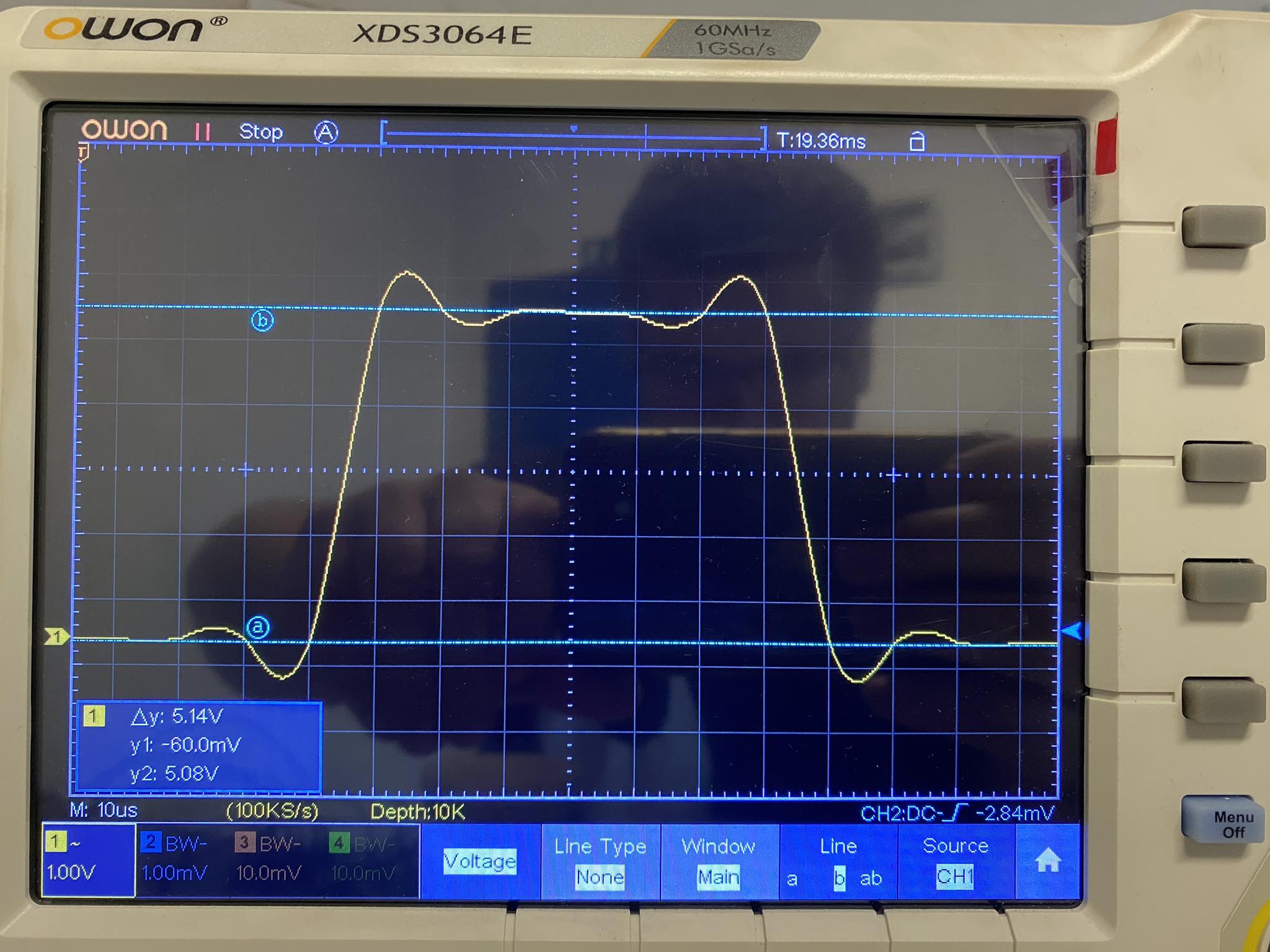

Osciliskop shows nothing. Literally 0V.

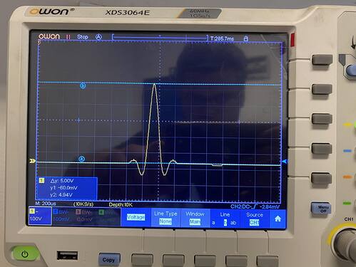

But I realised that I had the ROT connected to ground all the time. I actually bought their test board from icHaus (https://www.ichaus.de/upload/pdf/NV_NVH_datasheet_E1en.pdf page 20).
I connected R+ to PZERO, R- to NZERO and was watching Output from icHaus. . I don't know why it has a different shape, before I saw it as a square signal...see post #13, but it already has 5V. The second picture is the same output but I changed the ROT switch.
Are you using a x10 probe?
If so, have you compensated it?
No x1
